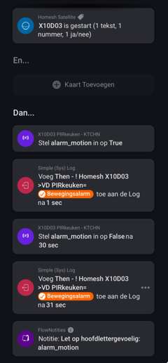

On my homey pro 2018 I have this flow.
(Ignore the doublecheck part, the X10 sensor is sending the signal twice. The doublecheck prevents triggerig the flow twice.
On my homey 2023 this one
I have defined a virtual device that acts like a motion sensor. That device is now in sync with the other homey.
