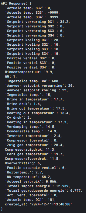

Hi @Peter_Haijen,
you can run the command:
console.log("API Response:", latestDataStats);
This gives back all the available responses of the API. Sending commands is still not possible I guess.
In my case:
And these are the readouts I do:
    Timestamp: { value: latestDataStats.created_at },
    Binnentemperatuur: { value: parseFloat(latestDataStats['Binnentemperatuur']) },
    WW_temperatuur: { value: parseFloat(latestDataStats['WW temperatuur']) },
    Brine_in_temperatuur: { value: parseFloat(latestDataStats['Brine in temperatuur']) },
    Brine_out_temperatuur: { value: parseFloat(latestDataStats['Brine out temperatuur']) },
    Brine_druk: { value: parseFloat(latestDataStats['Brine druk']) },
    Heating_in_temperatuur: { value: parseFloat(latestDataStats['Heating in temperatuur']) },
    Heating_out_temperatuur: { value: parseFloat(latestDataStats['Heating out temperatuur']) },
    Buitentemp: { value: parseFloat(latestDataStats['Buitentemp.']) },
    Cv_druk: { value: parseFloat(latestDataStats['Cv druk']) },
    Actueel_verbruik: { value: parseFloat(latestDataStats['Actueel verbruik']) },
    WW_ingeschakeld: { value: parseFloat(latestDataStats['WW']) },
    Ingestelde_temp_WW: { value: parseFloat(latestDataStats['Ingestelde temp. WW'])/10 },
    Aanvoer_setpoint_verwarming: { value: parseFloat(latestDataStats['Aanvoer setpoint verwarming']) },
    Aanvoer_setpoint_koeling: { value: parseFloat(latestDataStats['Aanvoer setpoint koeling']) },
    Ingestelde_temp: { value: parseFloat(latestDataStats['Ingestelde temp.']) },
    Condensatie_temp: { value: parseFloat(latestDataStats['Condensatie temp.']) },
    Compressor_toerental: { value: parseFloat(latestDataStats['Compressor toerental']) },
    Zuig_gas_temperatuur: { value: parseFloat(latestDataStats['Zuig gas temperatuur']) },
    Pers_gas_temperatuur: { value: parseFloat(latestDataStats['Pers gas temperatuur']) },
    Compressorzuigdruk: { value: parseFloat(latestDataStats['Compressorzuigdruk']) },
    Compressorafvoerdruk: { value: parseFloat(latestDataStats['Compressorafvoerdruk']) },
    Positie_expansie_ventiel: { value: parseFloat(latestDataStats['Positie expansie ventiel']) },
    Totaal_import_energie: { value: parseFloat(latestDataStats['Totaal import energie']) },
    Act_vent_toerental: { value: parseFloat(latestDataStats['Act. vent. toerental']) },
    WW: { value: parseInt(latestDataStats['WW']) },
    Oververhitting: { value: parseFloat(latestDataStats['Oververhitting']) },
    Totaal_geproduceerde_energie: { value: parseFloat(latestDataStats['Totaal geproduceerde energie']) },
    Verdamping_temp: { value: parseFloat(latestDataStats['Verdamping temp.']) },
    Inverter_temperatuur: { value: parseFloat(latestDataStats['Inverter temperatuur']) },

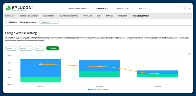

Hi Peter, First in my case there are values available in the API since July 2024 but in the interface since recent… Do you have this as well?
“Actueel verbruik”:1.843,
“Totaal import energie”:10.529,
“Totaal geproduceerde energie”:6.171,
Any Idea what this is?
I hope it is usage, but don’t get why it doesn’t count up…
Screenshot:
