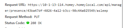

To find out…
Open a Browser to the API documentation,
https://developer.athom.com/docs/api/HomeyAPI.ManagerPresence.html
Open a Web Api Playground
https://developer.athom.com/tools/api-playground
Open Inspect (Ctr-Shift-I)
Get your ID
Homey.users.getUserMe();
Try…
Homey.users.updateUser({id:'43ba47df-4026-4a12-b3cc-90c44a025549',user:{asleep:true}})
Error: Parameter 'asleep' is read-only.
And don’t give up…
Homey.presence.setAsleep({id:'43ba47df-4026-4a12-b3cc-90c44a025549',value:true})
Happy Hacking :wink:

Hmm, guess I was a bit quick. Seems like I ran into another noob issue right away. It appears as it works as intended from the Web API Playground. But when trying in Postman or RESTask in Tasker it toggles the value every time I run a PUT. I was expecting it to change to or not change if already the same.
I’m probably not formatting the value {“asleep”:true} (and a few variants) in the body correctly. If I remove it completely, I still get the toggle behavior.
