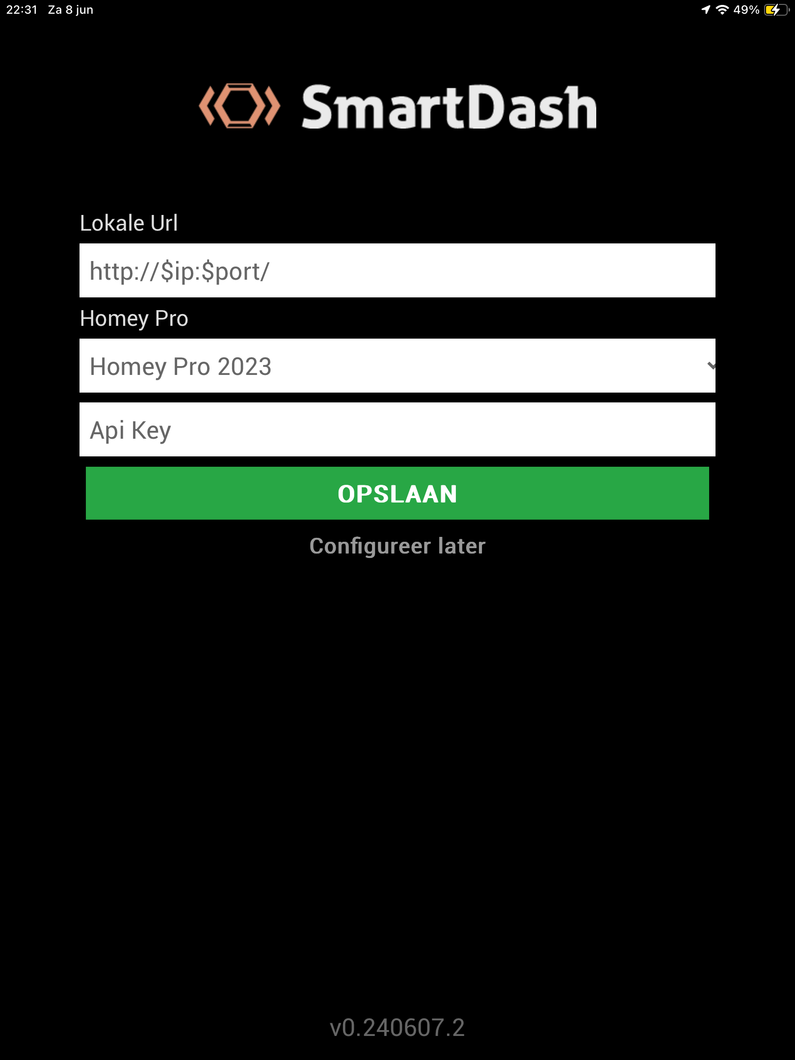

I have installed SmartDash on my iPad and iPhone. On the iPad, the app won’t go beyond the image, while it works on my iPhone with the same settings. Why won’t the iPad start further?

I have now reinstalled the app. The configure later button does not work. I can’t get any further than the screen below.
:thinking: why not configure it??
then I won’t get much further, see post 1640
OK, my mistake :blush: did not read the answer you had
But still you could try it again then (?)
Tried a new installation: Here no problem with ‘configureer later’ But on Android. You checked security settings in IOS?
In iPhone work, What Ipad and What Ios?
I have an iPad 2019 with iOS 17.5.1
OK tomorrow i test with iPad emulator
A question, Homey is 2023 or previous?
Homey 2023. Thanks in advance!

v0.240610.1 - release 1.4.54
  • I have fix the bug, ipad was identified as Android tablet
