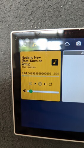

Yes, much easier to read now :wink:. My Sonos info isn’t updated, but also not within Homey so Sonos probably broke something with the new app of them.
Probably already there in previous version: when I change the volume, song is named 'Diffusion: something' and artist set to Spotify. After some time the right names appear.
OK, never mind; this also happens in Homey. But refreshes faster so less obvious
The 16:10 format is an improvement: less unusable space and an extra row in enduser panels. All widgets went well, only the renewed Speaker widget was a mess with the ‘old’ CSS. After changing the CSS it is oke again.

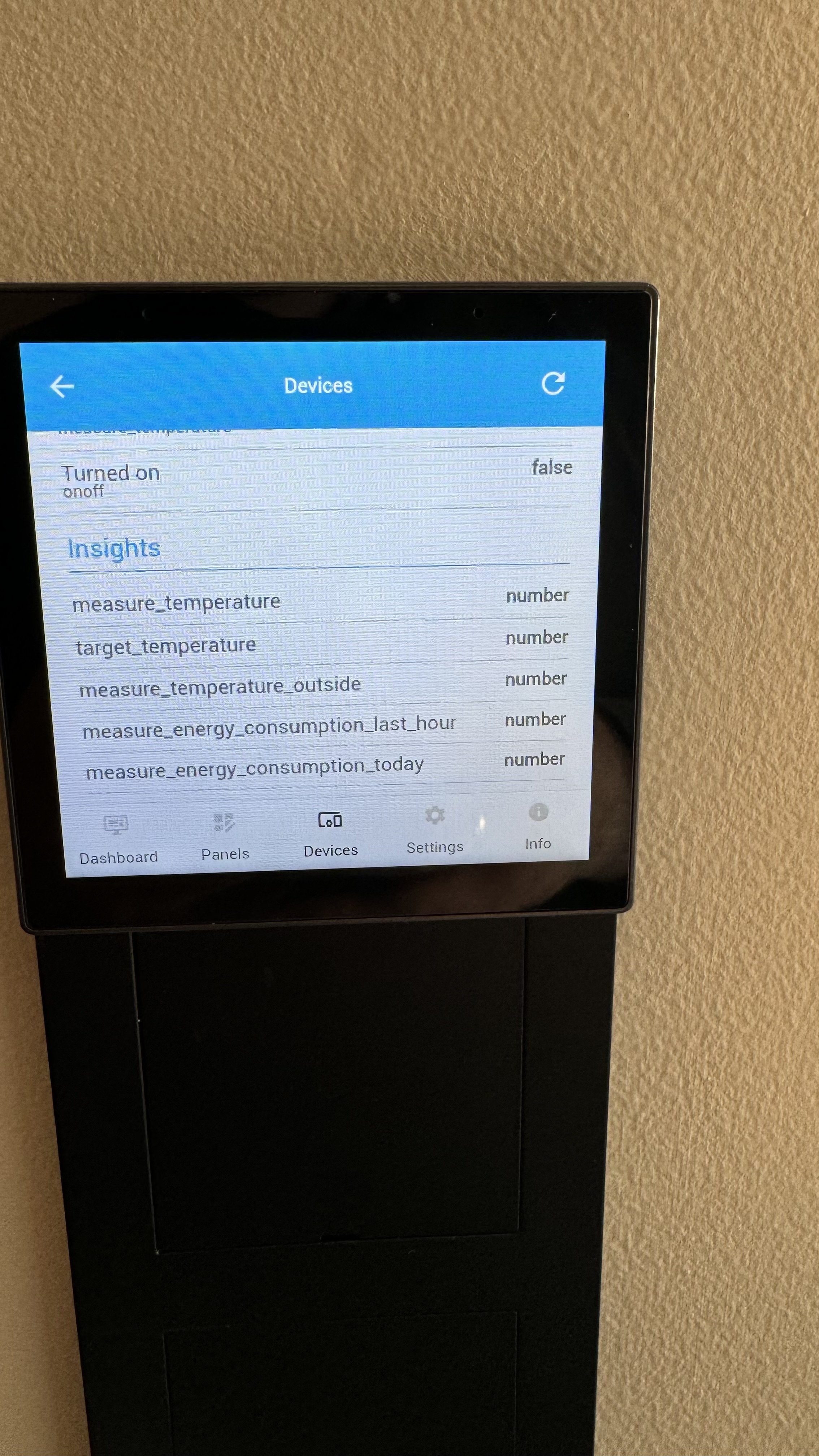

Have set up an aqara G4 to show video feed when the doorbell is pressed. But the video takes 5-10 seconds to load when the panel turns on. Is it possible to get it to load the feed when the variable to put it in to full screen is set?

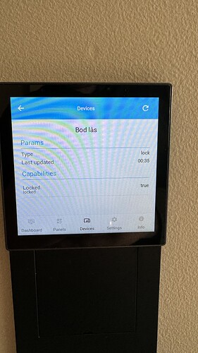

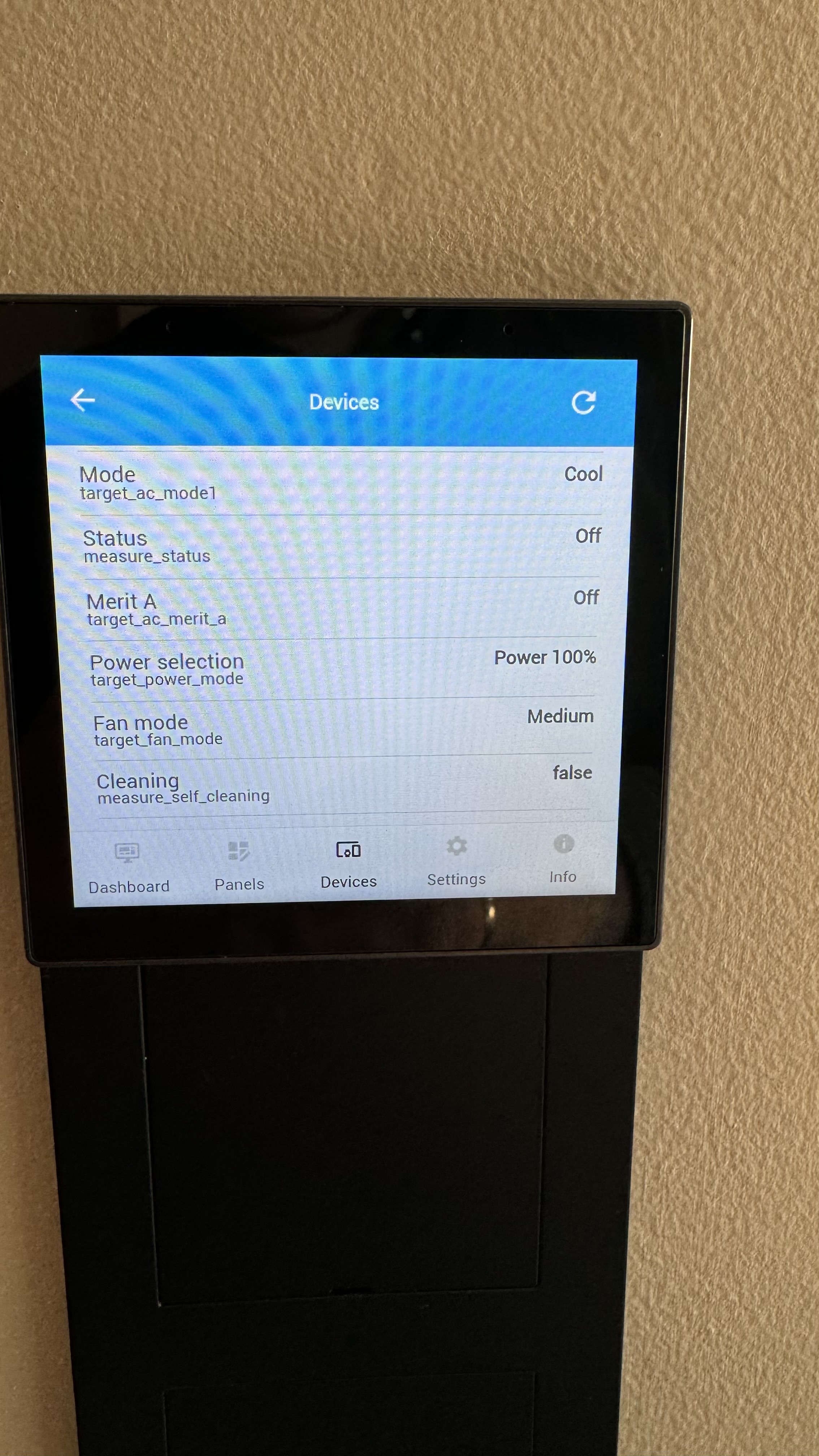

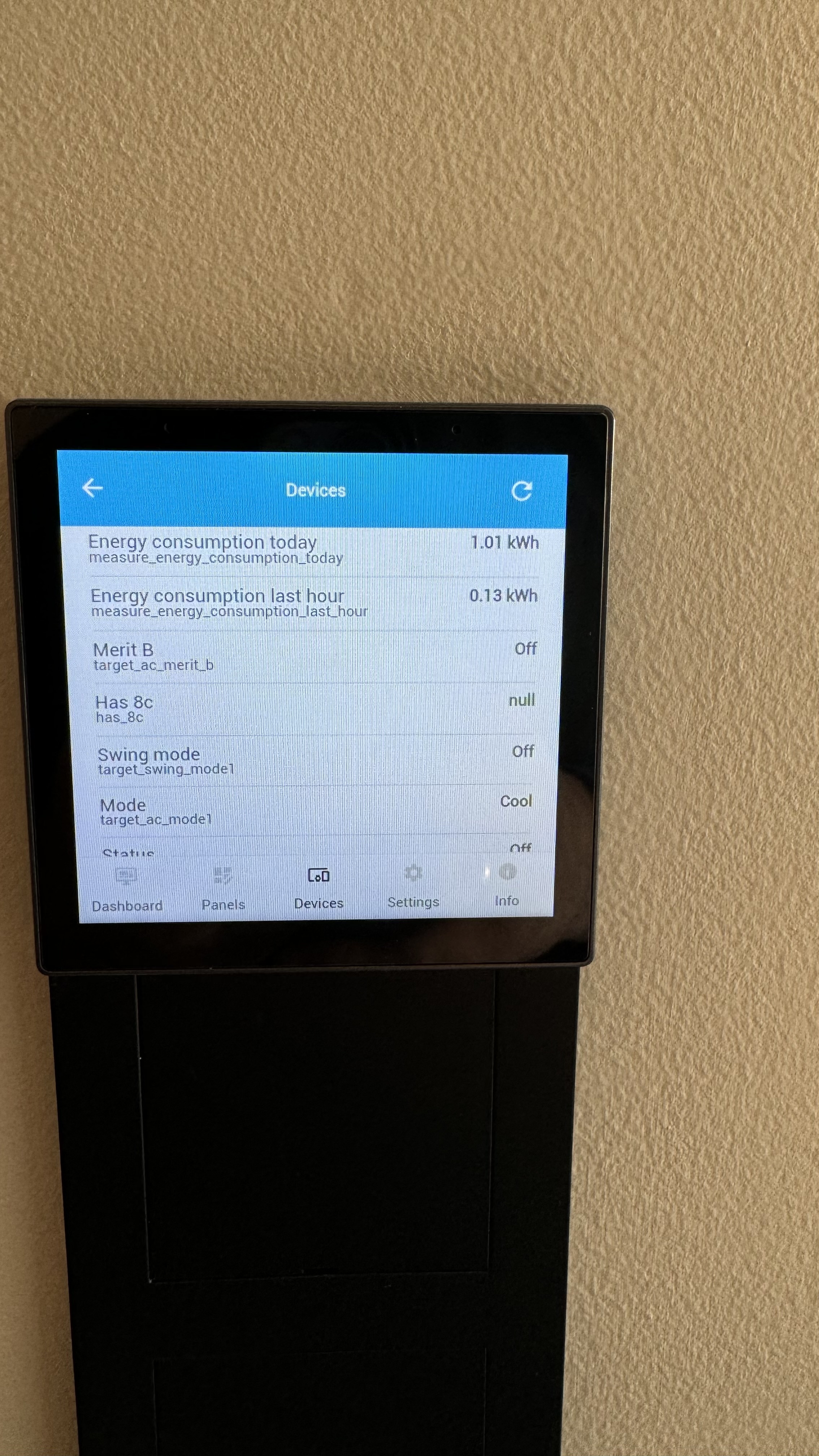

Also a request to support device type:
-Lock
  • AC (thermostat but with fan😂)

the lock device has the locked capability. if you change it to false it open the door lock?
