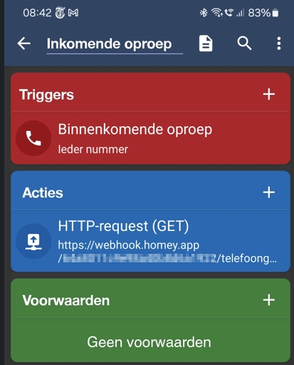

I m definitely interested in the link with macrodroid, i m using it to automate some parts my phone quite some time, so i hyve the paid version
Example of MarcoDroid receiving a caller name in a phone call and sending to Homey and SmartDash:
  • get on Homey Developer Tools your Homey cloudid
  • create in MacroDroid on your Andrfoid device a new macro. Steps:
  1. Trigger: Incoming phone call
  2. Action: GET HTTP-request. URL:
  • fixed: https://webhook.homey.app/
  • your cloudid found above
  • custom name you can define yourself (needed when you want to define one or multiple HTTP requests on the same cloudid/Homey device), in this case telefoongesprek
  • tag you can select from predefined MarcoDroid variables with blue search button, in this case call_name
https://webhook.homey.app/your cloud id/telefoongesprek?tag={call_name}

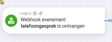

  1. create an Advanced flow starting with receiving a Webhook event. Type in manually the eventname defined in URL, in this case telefoongesprek
webhook3
4. this webhook contains one variable: a tag, which is the value you defined in tag={call_name} (so, it’s the name of the caller)
webhook4
