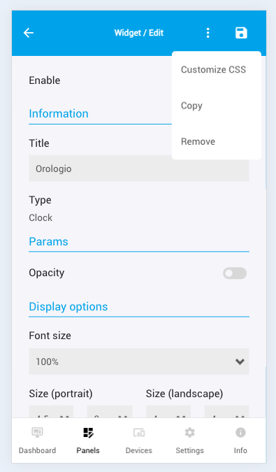

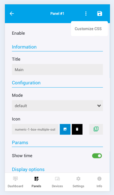

Other thing I’m trying is to set panel css for genericsocket widgets, can’t get is to work. What am I doing wrong?
.dashboard { background: url("https://images.hdqwalls.com/download/abstract-cube-digital-art-5k-hc-480x800.jpg ") no-repeat center -40px; background-size: cover }
.dashboard .widget .genericsocket .content {background: rgba(0,0,0,0.7);box-shadow:1px 1px 5px #00FFFF}
.dashboard .widget .genericsocket .content .box {margin-top: -10px}
.dashboard .widget .genericsocket .content .mdi {font-size: 50px}
.dashboard .widget .genericsocket .content .name {margin-top: 70px; font-size: 14pt; font-weight: 550}
.dashboard .widget .genericsocket .tapped .content {background: rgba(0,255,255,0.7)}
.widget.genericsocket
No space
great that was it! thanks

Is not working in panel CSS I need to put it in the widget. Is this because it is a triggered function?

I don’t remember where is added .tapped, try to concatenate with .genericsocket or .content
it was .genericsocket.tapped concatenate indeed!
Love this ability to set global page css, saves a lot of time!
Only have to set it one time per page and every widget I add get its layout!
