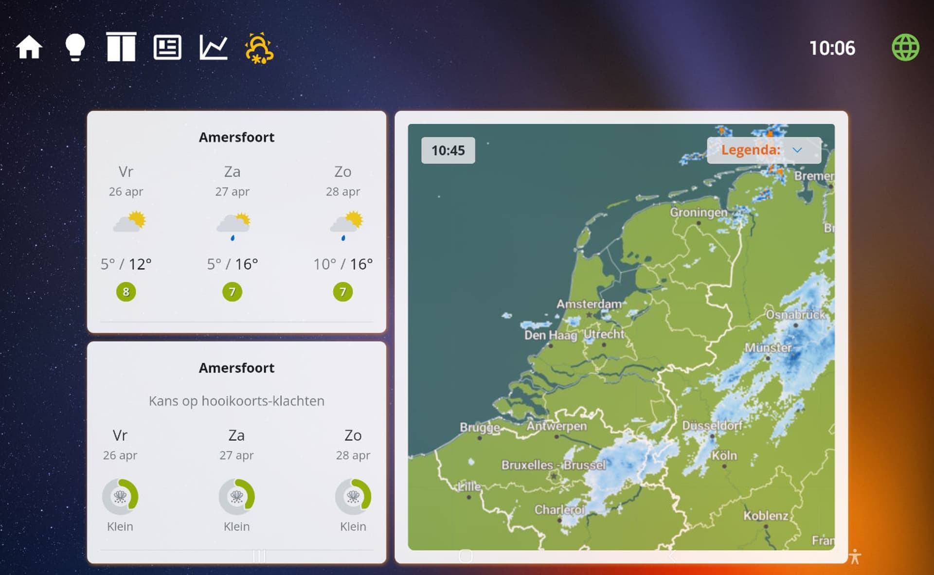

Below you can see some of my SmartDash screens with an Italian sunny layout (for the Dutchies tomorrow: an “oranje” lay-out for kingsday :crown: :grinning:).
Suggestions are appreciated. Others could share their screens and ideas too.

Weather forecast, rain forecast and hay fever forecast:
Beautifull :slight_smile:
