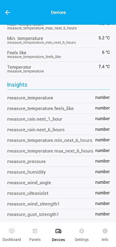

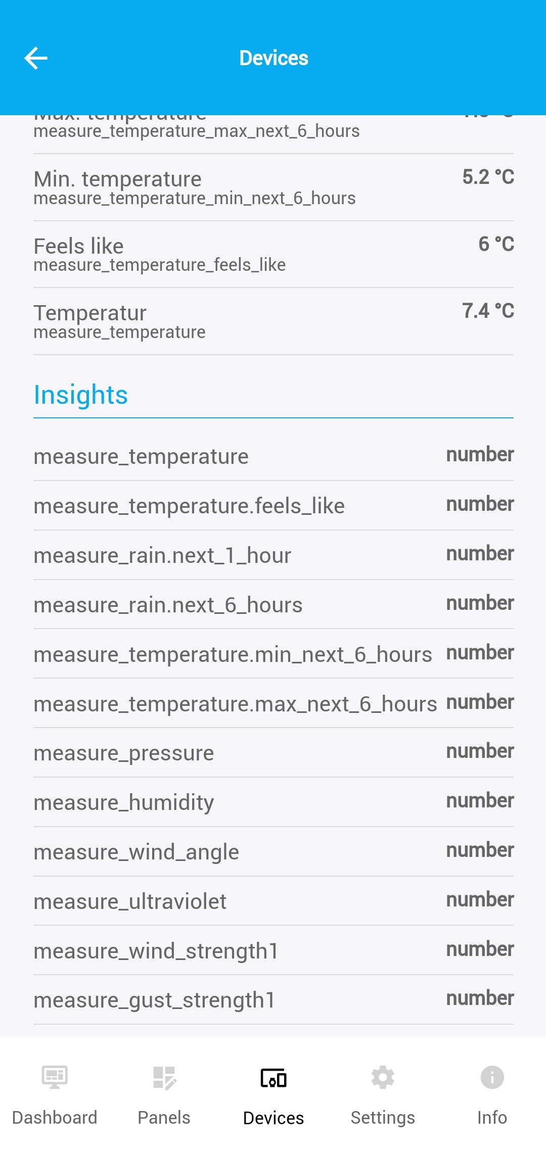

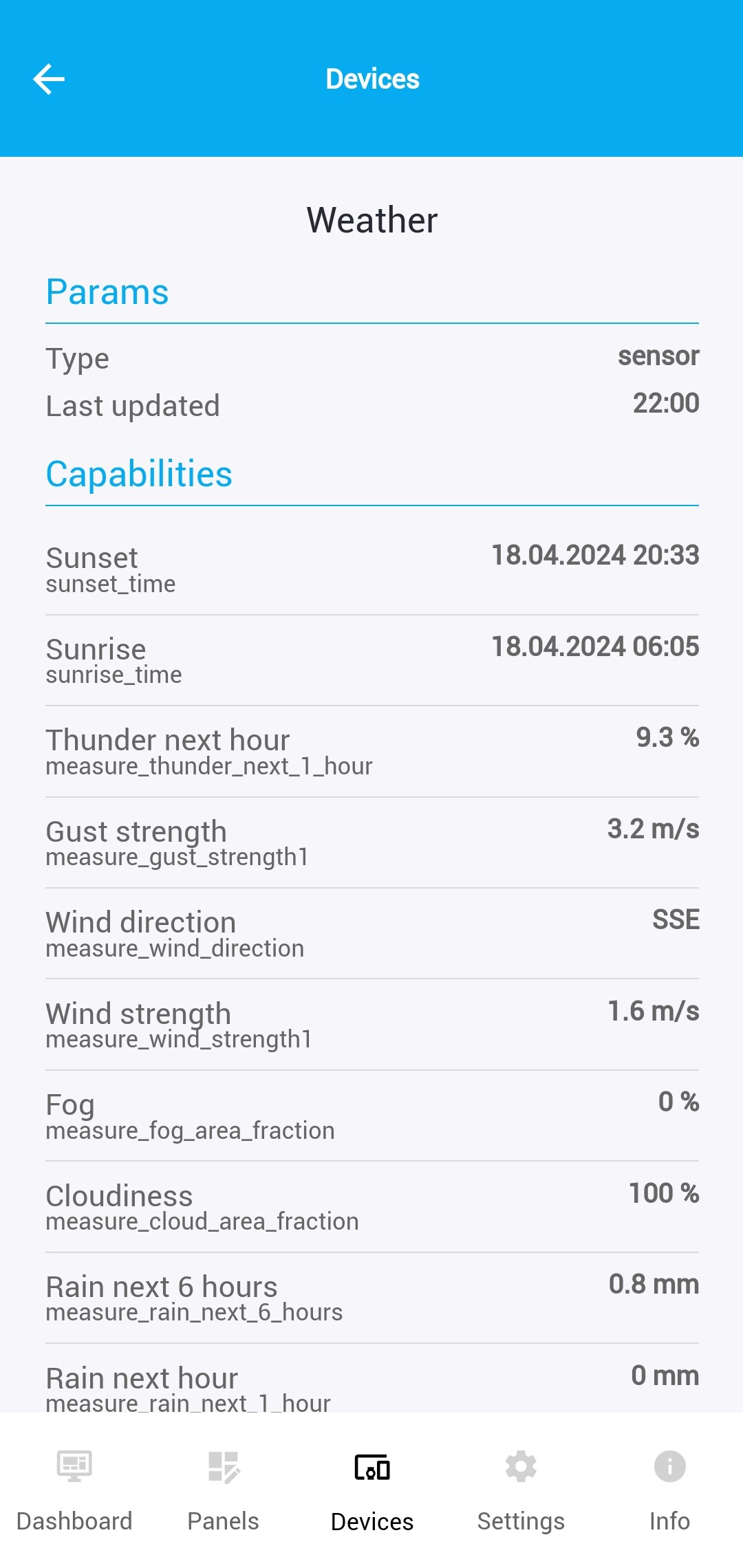

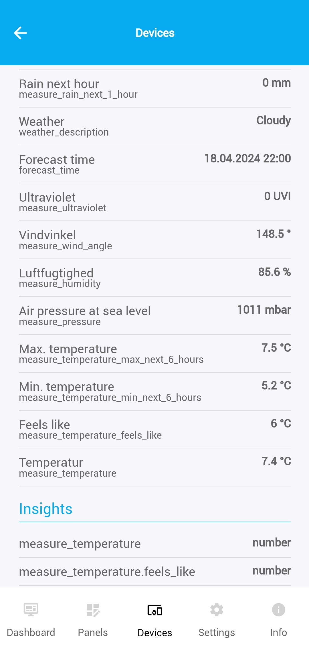

I added the YR weather forecast app in Homey and installed the device.
When I try to create a weather tile, I don’t get any options in the device dropdown. Is there a bug or am I missing something?
Hi, try if it work in screensaver. If yes i need to add provider in widget. If not, send a screenshot of this device capabilities
Hi
It was not in the Screensaver dropdown either.
Here are the screenshots:
Tomorrow i add it!
