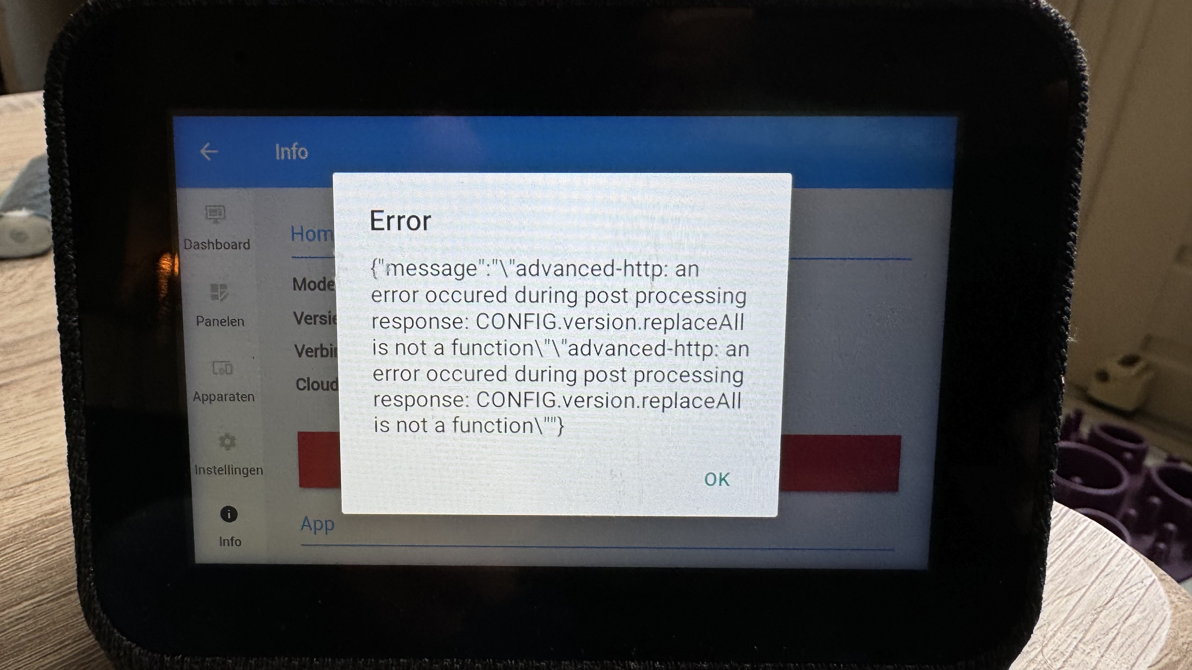

Going to info I get this:
It appears that the function “replaceAll” is not supported in your device. Need a workaround for this (it’s the same problem for the timeline widget)
Try the new test10.apk.
perfect ![]()

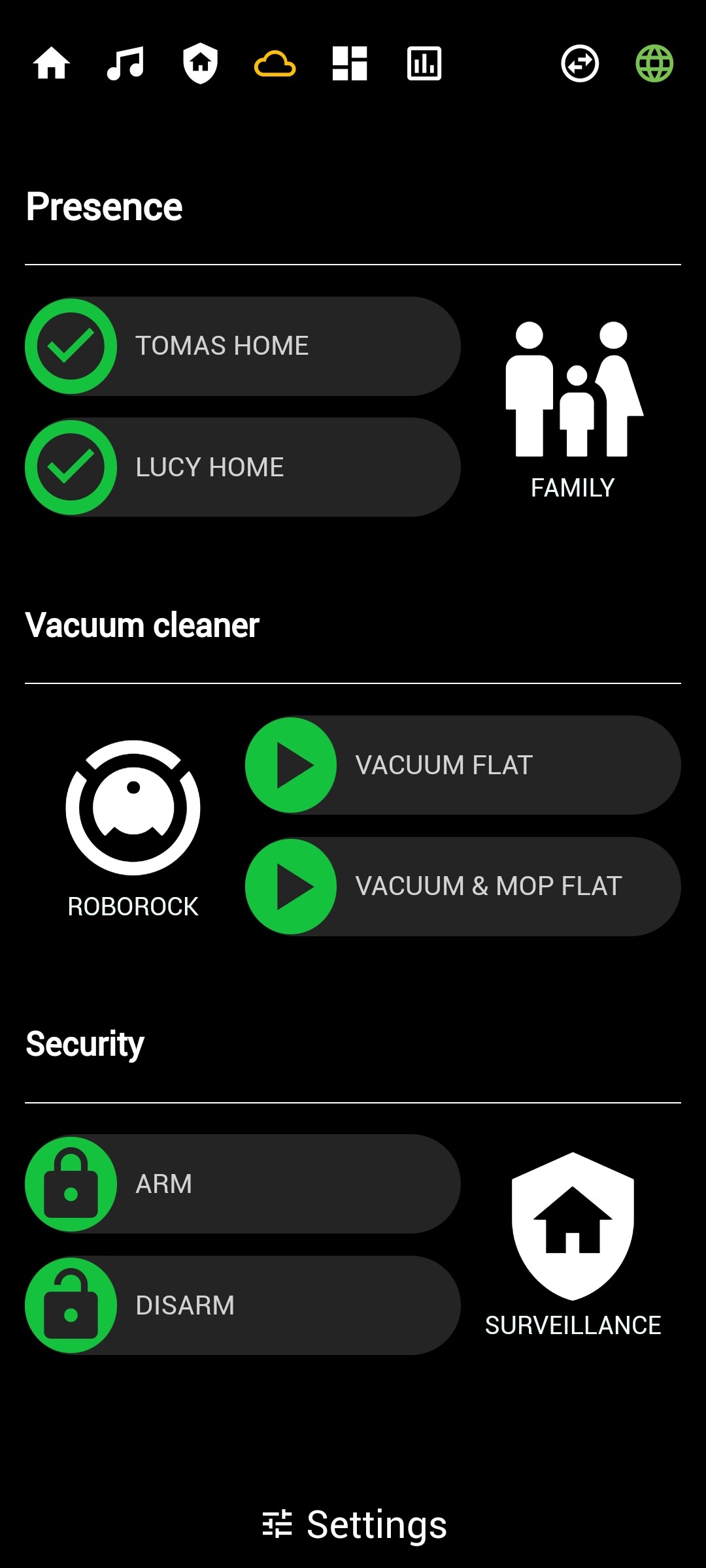

BTW, would it be possible to make custom backgrounds for the 6 screen tiles? This would make infinite options of customization, as I could basically only draw in photoshop the design of any tile visual and overlay it with buttons with css opacity:0 (display: none would cause it to do not respond to touches) to make ANY crazy design possible

wow, maded with CSS? amazing!
Yep. I just dont know how to change the icon by css so it would react on activation (e.g. when I press I m not home, change the icon to “x”). Should be possible though. Advice?
yes you can, example:
.content .mdi::before {
content: "\F0002";
or if you know the icon name…
.content .mdi-power::before {
content: "\F0002";
But I think it’s better to change the icon when the status is on/active/alarm
.on .content .mdi-power::before {
content: "\F0002";
Reference for codes: mdi
