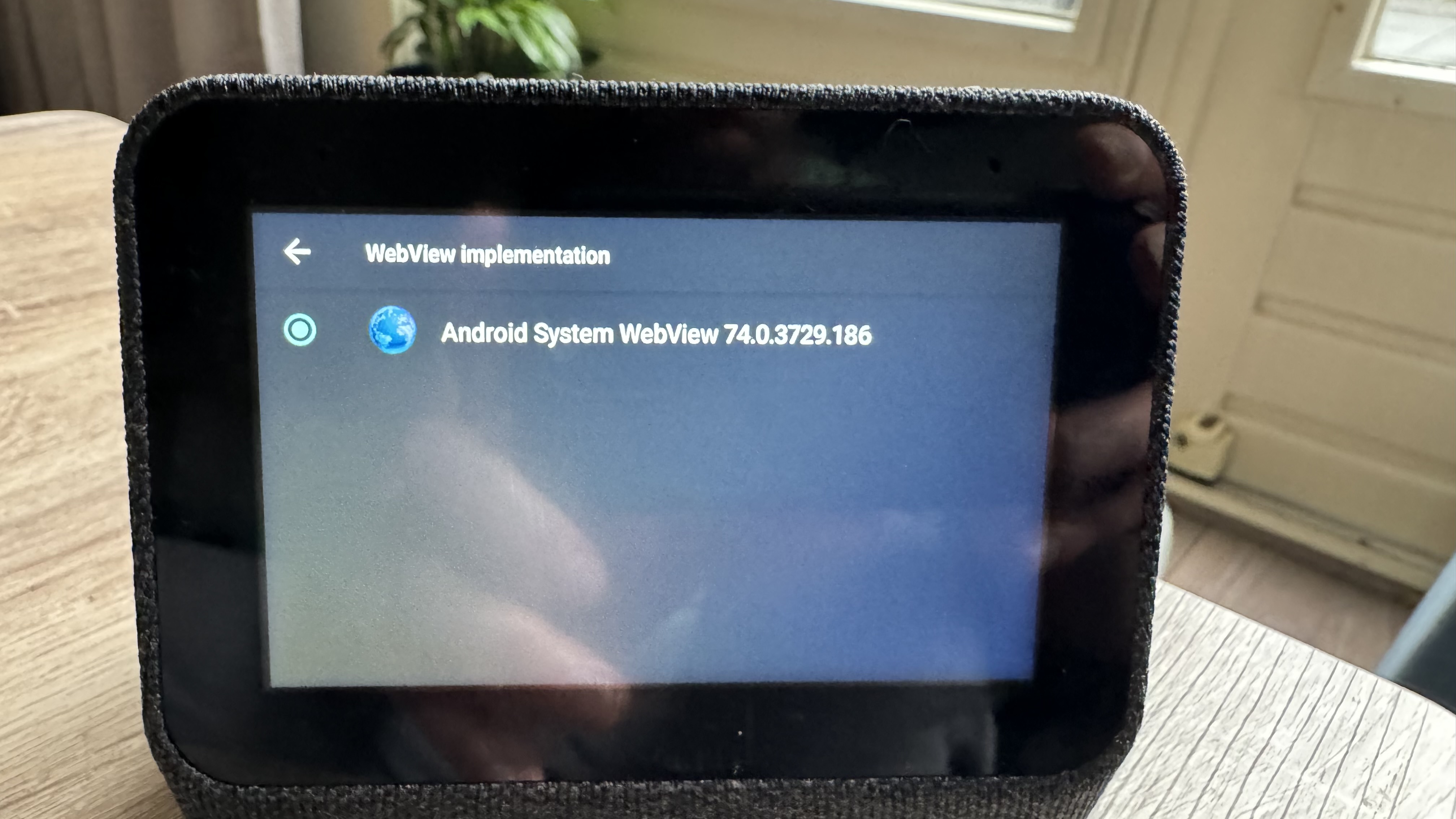

Maybe this custom android build is not compatible with your app:

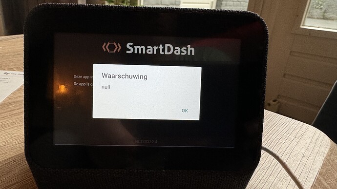

so the app always crashes on startup and no message?
Try the latest app, v0.240322.7 (10291.apk)
If donāt work, and no message, need specific test
EDIT,
i have update app, i try to catch the generic error
Tested with new version. Android was in dutch language. After install I could login. Close app, open app Iāve got Error popup {}
Monday i make a lite app with some debug info for try to check where is the error and if can be fixed
