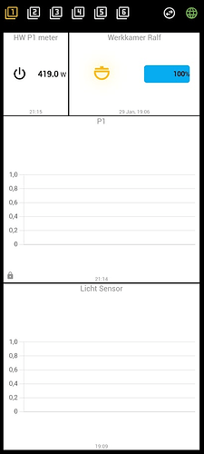

The SmartDash is working on my phone now, with automatic token retrieval. Very nice!
Only the insight data is empty. @Julien_Moors do you see something in combination with a HP2019?
Wow, fast. Thanks a lot, will try it out ASAP! :slight_smile:
What type of insight is it? I tested temperature, humidity, power and simple number.
What resolution is it?
I tested with different things. I have luminance (Licht Sensor) for the last 24h.
The one below is power. I changed almost every setting, so it’s a little strange now…
I try to check if they are some regression.
Maybe there is some strange data that corrupts the graph.
Try with only one insight if it show.
Maybe it the same problem with timestamp formatting!
MFA is causing this error. I made a separate account for my Dashboard without MFA. This account is also in the BearerToken script.
What is MFA? :thinking:
edit, Multi-Factor Authentication :slight_smile:
@Ralf_Groot ,
try this homeyscript with your device and check results:
let uri = 'homey:device:9d2e9a13-fb7c-4619-83e0-a00f56bcf5d7';
let insight = 'measure_current.number4';
let resolution = 'today';
logs = await Homey.insights.getLogEntries({ 'uri': uri, 'id': uri +':'+ insight, 'resolution': resolution});
log(logs.values);
replace uri and insight with your device info, it should return something like this:
  { t: '2024-02-07T23:00:00.000Z', v: 100 },
  { t: '2024-02-07T23:05:00.000Z', v: 100 },
  { t: '2024-02-07T23:10:00.000Z', v: 99.98333333333333 },
  { t: '2024-02-07T23:15:00.000Z', v: 99.01666666666667 },
  { t: '2024-02-07T23:20:00.000Z', v: 100 },
  { t: '2024-02-07T23:25:00.000Z', v: 99.98333333333333 },
  { t: '2024-02-07T23:30:00.000Z', v: 99 },
  { t: '2024-02-07T23:35:00.000Z', v: 98.98333333333333 },
  { t: '2024-02-07T23:40:00.000Z', v: 98 },
  { t: '2024-02-07T23:45:00.000Z', v: 98.03333333333333 },
  { t: '2024-02-07T23:50:00.000Z', v: 99.98333333333333 },
  { t: '2024-02-07T23:55:00.000Z', v: 98.98333333333333 },
  { t: '2024-02-08T00:00:00.000Z', v: 98.03333333333333 },
  { t: '2024-02-08T00:05:00.000Z', v: 100 },
