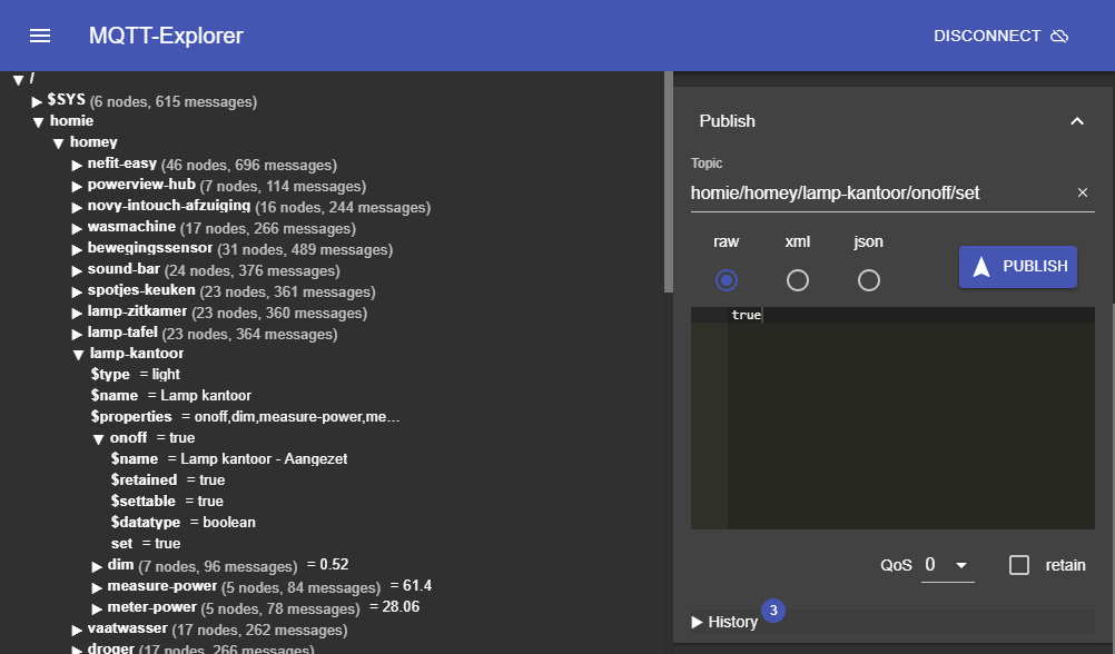

Can you set the values using the MQTT Explorer?
This works for me (turns light on):

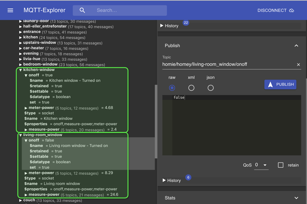

Ok I’ve got some interesting news. I have two lights, kitchen window and living room window. One of these I can control through MQTT but not the other. Both are shown as channels in OpenHAB both are updated in the broker when I change the state of them manually through Homey but only one of them responds to the “set”-attribute in the MQTT-broker.
And well one I can also control in OpenHAB as well as manually in MQTT-explorer. The other doesn’t respond.
EDIT:
And it is shown in the Client log that it receives “false on homie/homey/kitchen-window/onoff” when it’s triggered through OpenHAB.
But if i try to trigger the livingroom-window nothing comes through on the log.
But it does send out the state of it (livingroom-window) from homey to the broker, just not the other way around.

It seems as the name might be incorrect in the MQTT-broker.
In Homey it’s called “Living Room Window” but in the broker “Living-Room_Window”
Those with only one space in their name “Kitchen Window” in the broker called “Kitchen
-Window” seem to work.
I changed the name to “Livingroom Window” and it started to work.
Found it! It’s the _ in the device name (reserved by Homie convention). Already tried to fix that one (thought it was). It is a bug in the topic name normalization code. Need to have another look at it I guess! Problem only exists for device names with more then two words (> 1 space).
Thanks a lot for the help, you are correct. This solved the problem. Everything I’ve found so far seems to work now!
