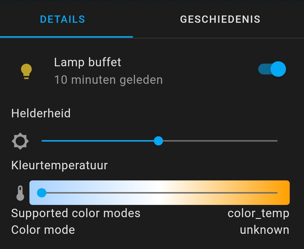

Wow, thx @HarriedeGroot!
Now I am able to change color temperature from within HA. The value in Homey gets updated accordingly (obviously). Great!
But the value set in Homey doesn’t get updated in Home Assistant.
And the setting ranges from 153-500. 1-100 would be more logical. Or perhaps 2200-4000 K.
Is that a MQTT Client problem and/or something that can be finetuned?

Version 3.3.3
  • Color temperature fix: Homey => HA
Works like a charm, @HarriedeGroot!
Thanks, very much appreciated! :+1:t2::smiley:
To make it really neat, I have to find a way to change the min and max values in HA (now 153 and 500), but I suppose that has something to do with the calculations in HA.
