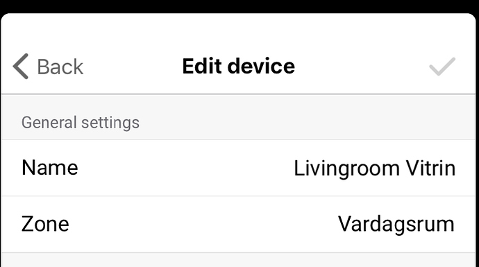

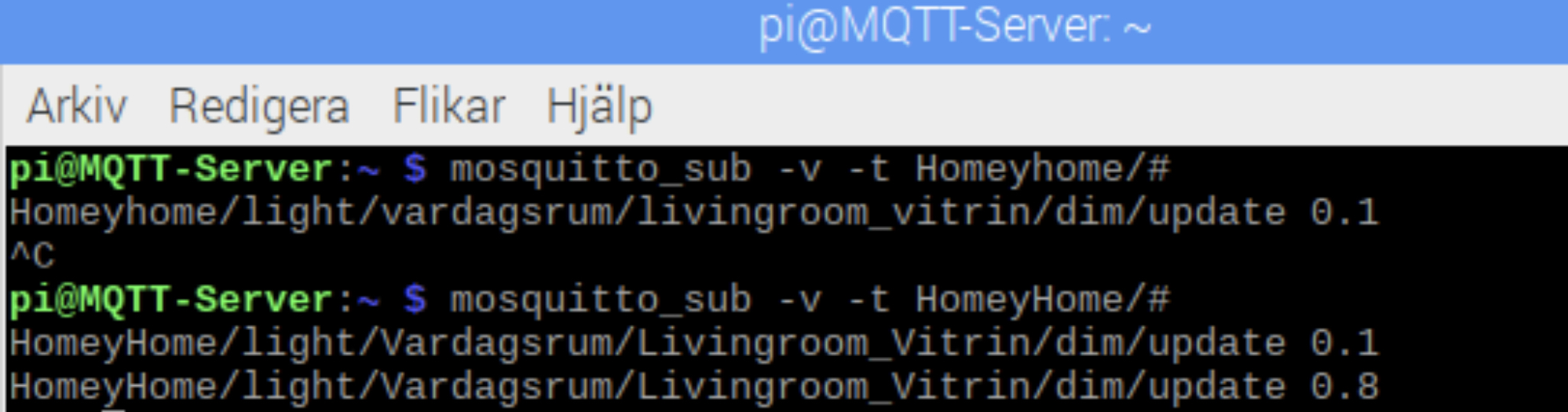

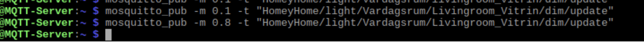

I am trying to set the dim level on a fibaro dimmer 2 in my livingroom
My Homey is called ’HomeyHome’
Mosquitto_pub -m ”0.5” -t ”HomeyHome/light/Livingroom/Livingroom Vitrin/dim/update”
Nothing is happening. Also tried with just ”homey/…” but same result.
What did I not get right?
Also, how do I send a ’describe’ command to list all devices?
The ’state’ repport comes out to the broker so mqtt is up and running.
Thanks
Helge
Try with ‘normalized’ names and remove the quotes around the value:
Mosquitto_pub -m 0.5 -t ”HomeyHome/light/livingroom/livingroom_vitrin/dim/update”
Get devices request has yet to be implemented (high on the prio list, see also posts about the homie convention above).
Do you get messages on ”HomeyHome/#"?
Note: The device name is also going to be normalized in the next version (small bug)
Still the same problem.
Topics are case sensitive, try:
Mosquitto_pub -m 0.5 -t ”homey/light/livingroom/livingroom_vitrin/dim/update”
I see Homey 1.5.13 has a small bug in grabbing the device name and will fallback to ‘homey’.

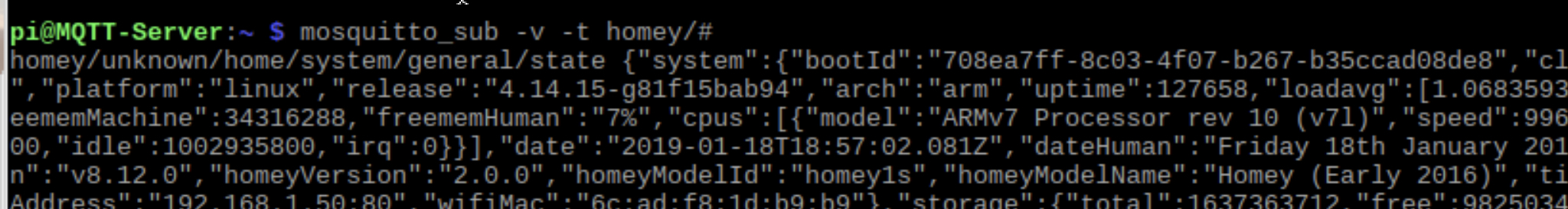

anyone who can help me because I only receive the system status “Homey/unknown/home/system/general/state” ?
I have tried some restarts of the apps and also of Homey itself, but still the same :man_shrugging:
Do you have some more info?
E.g. What’s your Homey firmware version?
Maybe your’re able to run the app via the athom-cli & grab the debug log?
You already receive the system info from the Gateway app. This means the connection with the broker (via the MQTT Client app) is working.

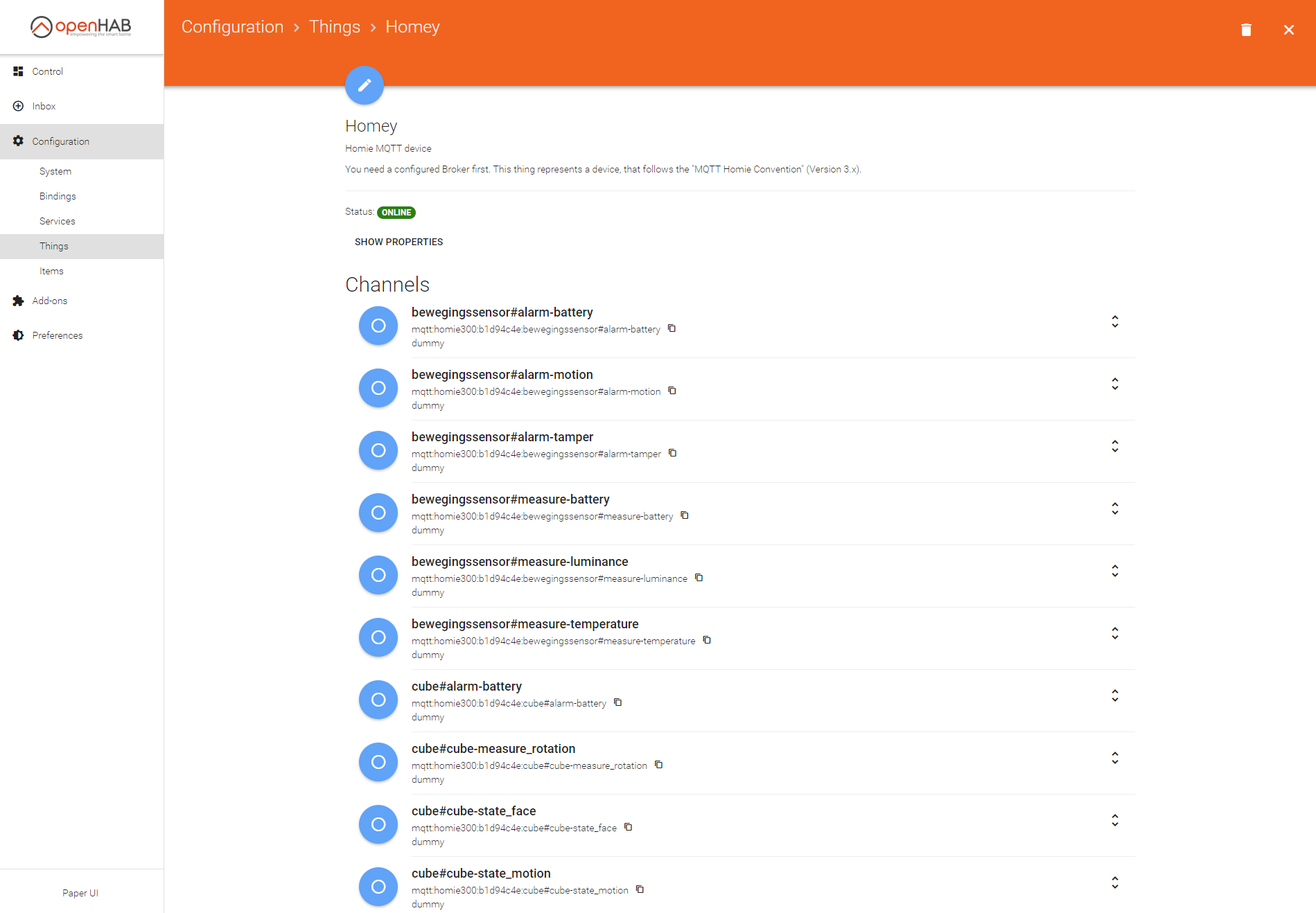

Sneak peek!
Device discovery within openHAB via the Homie Convention:

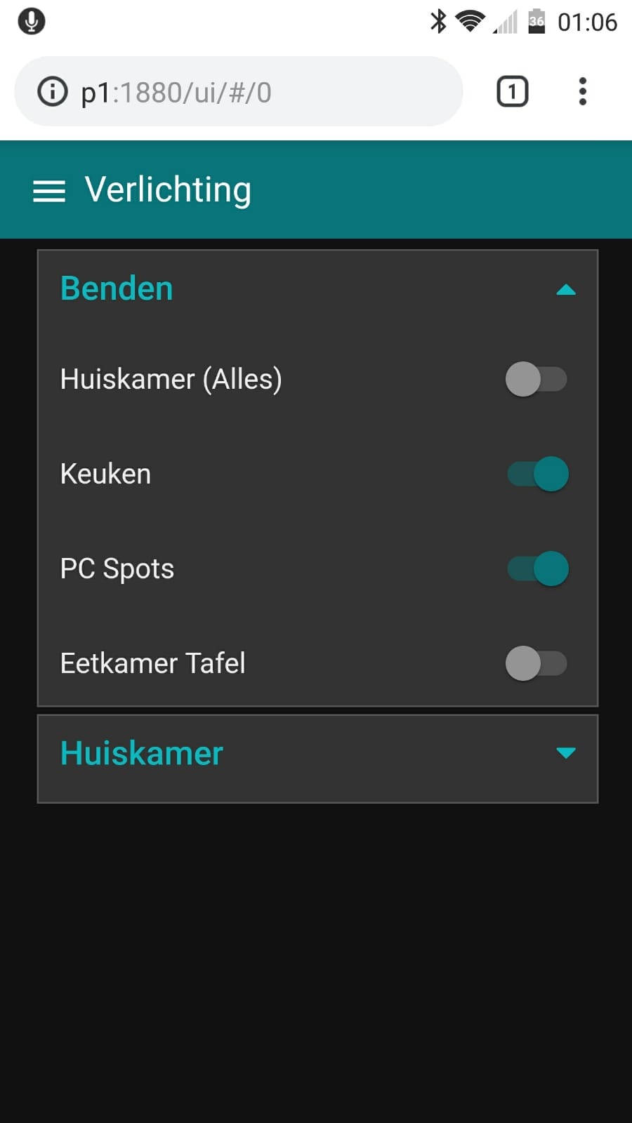

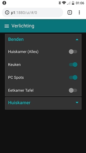

First impression of HABpanel using MQTT. It’s a working demo, including live updates & setting the values.
All devices and their properties (+datatypes) are automatically detected and imported via the Homie Convention:
