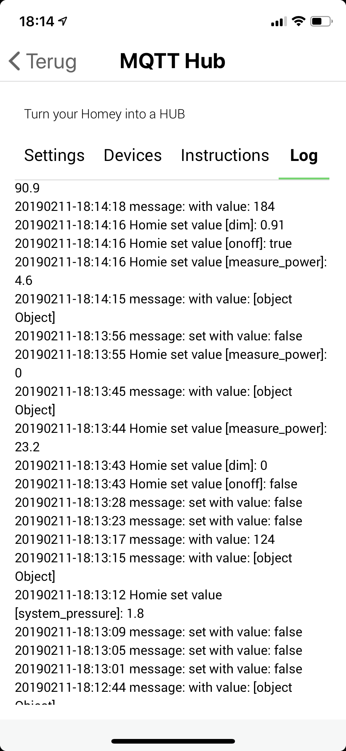

With this new version the dashboard HABpanel isn’t working anymore. see object,object items. after rollback to version 2.02 it’s directly working again without modifications on both sides.
@HarriedeGroot
Message seems to-be empty.
version2.04
version 2.02
@Sat2All I tried both the store version (2.0.4) & installed the beta branch via cli.
Both are working correctly here…I don’t see the empty messages (topic is correctly provided).

I also seem to have the same issue. Empty messages on incoming messages, sending seems to work fine. So whenever I have HA turn a light off, it recognizes a message has come in but it doesn’t actually turn the light off. Just using the default settings of the HUB (broadcasting to homie/homey). Already tried a fresh install from the app store. Old version (2.02) seems to work fine. I am on Homey FW 2.04 RC1.
This logging is with hub version 2.04 beta.

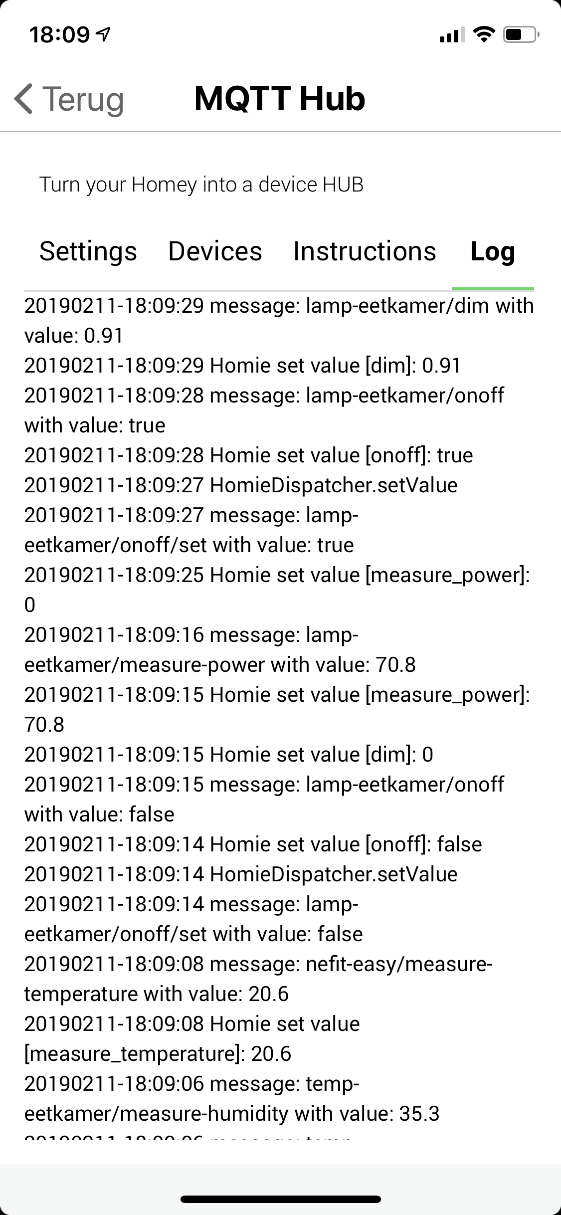

Control the light (Fibaro) with wall switch directly and sonos device volume up/down. Also here message is empty. So this test without OpenHAB. Seems something wrong in creating the message in the HuB.

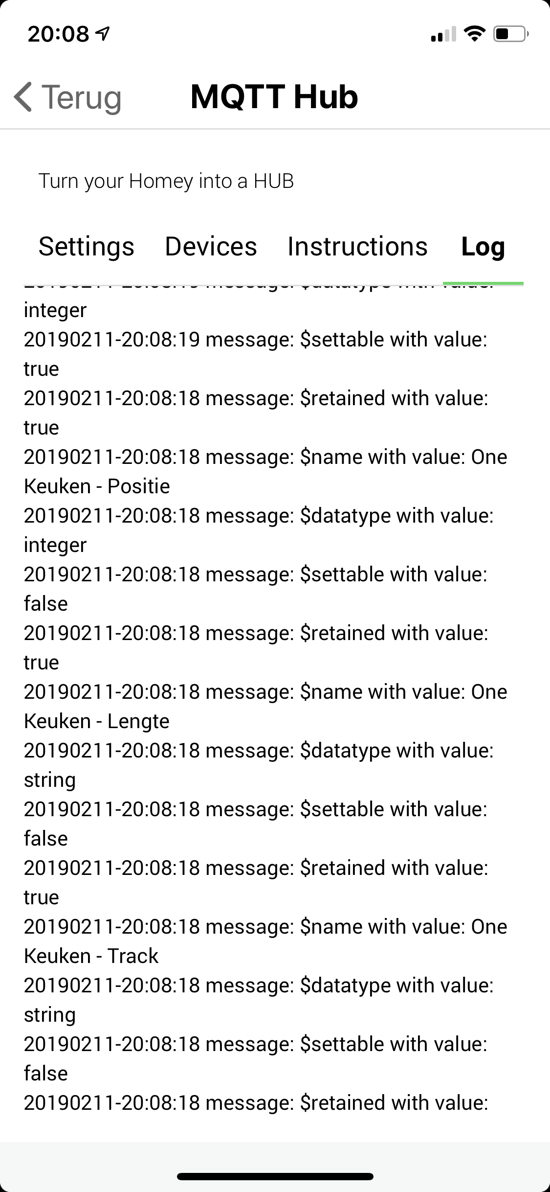

Did a fresh install of hub 2.04. This is during startup of the Hub. ( broadcast) as you can see also empty messages.

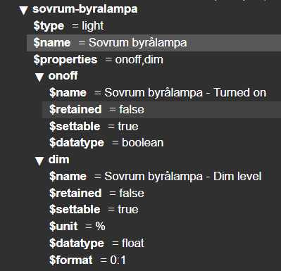

Have you tried removing the Nordic letters? Don’t think it likes æ,ø,å
