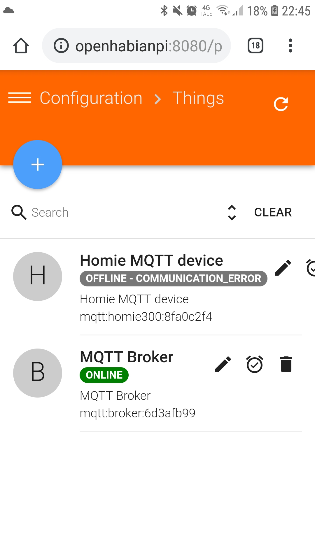

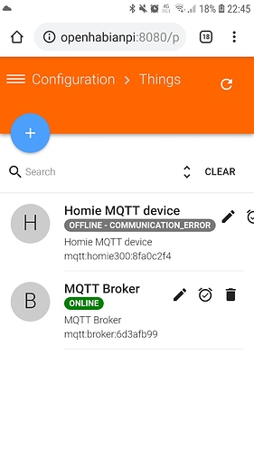

Trying to figure out whats going on…I still don’t know the reason, but at least I’m able to reproduce the issue now! I Added another MQTT Homie device as a test. This one is displayed offline while another is correctly displaying the online pending message. It’s the same configuration, strange…

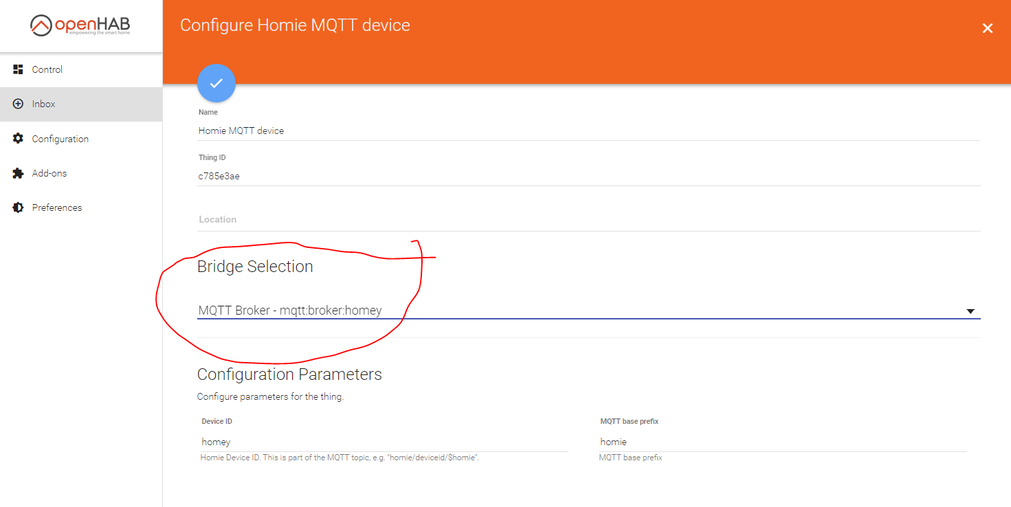

@Bananfluen Found it!
I forgot to select a bridge (the homey MQTT broker) when creating the MQTT Homie device.

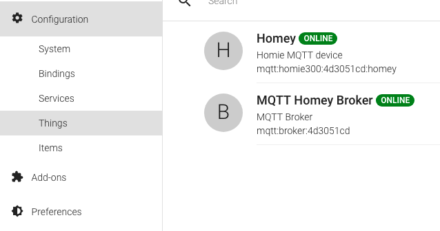

I have it online in OpenHAB and see channels when I click on the “Homie MQTT device”
