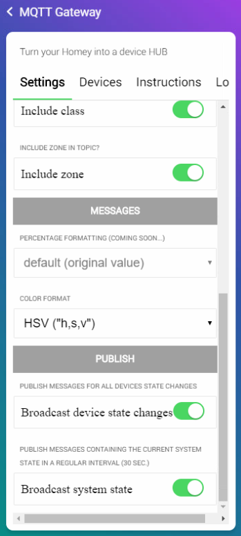

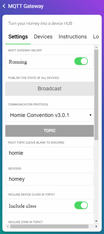

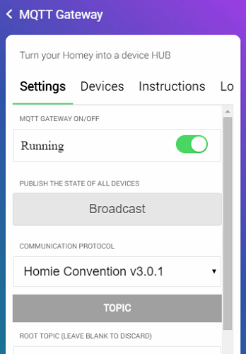

Here are the settings & log:
So Switch is ON but no mqtt messages are sent.
When i go back and in again into the settings the switch “Running” is off.
I turn it on but nothing happens.
