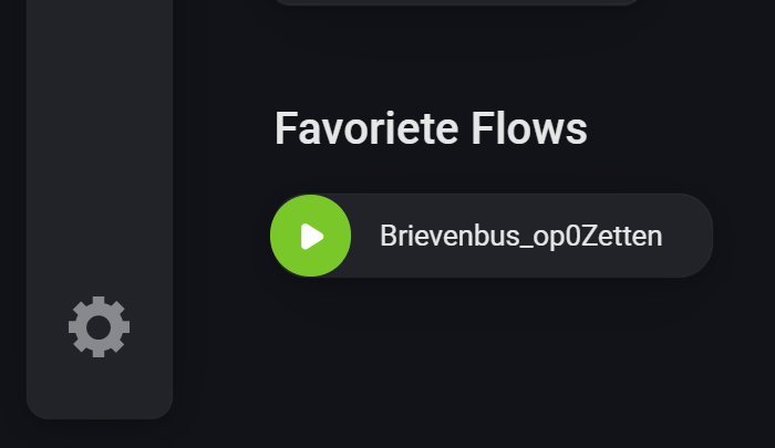

Resetting is indeed tricky I guess you will need a manual action for this just use a favorite flow to disarm the motor alarm (with android you are also able to make a widget shortcut on your phone screen)
