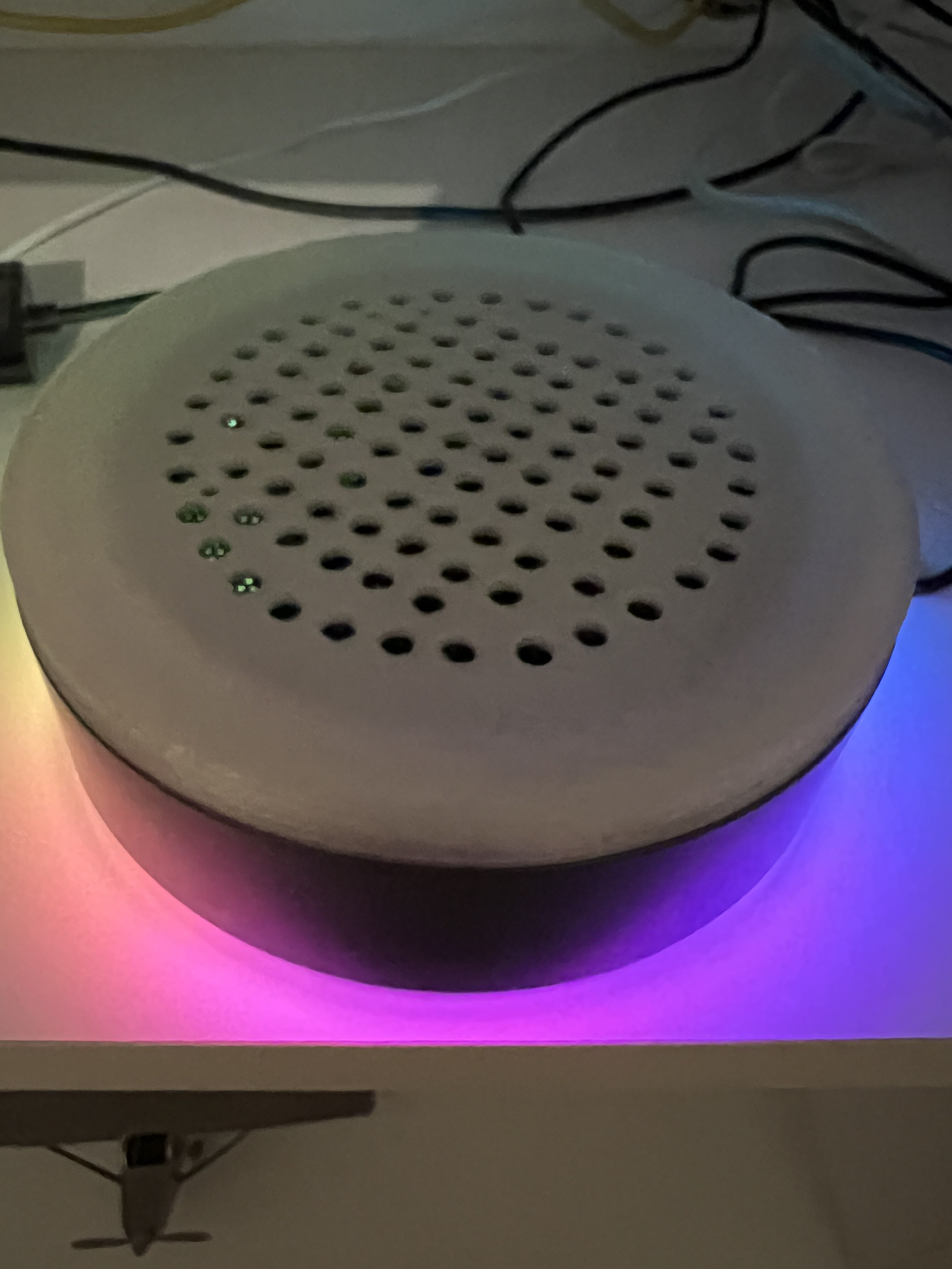

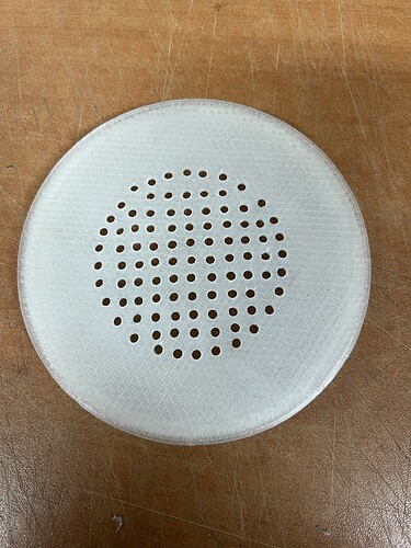

Thanks, here is the minimalist version :wink: It’s hollow, just 42min print.
https://www.printables.com/cs/model/575415-homey-2023-minimalistic-raiser

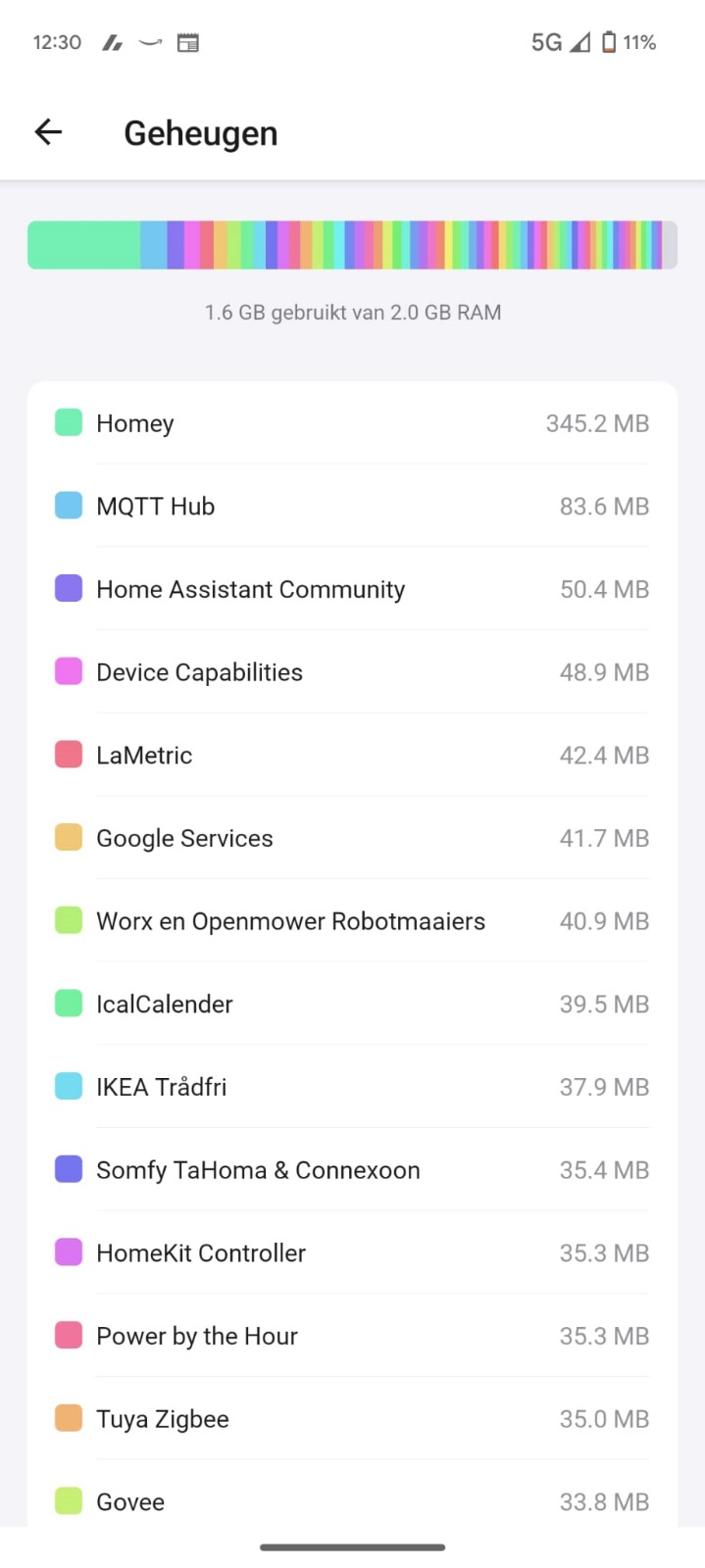

Nice!
But how did you go from 1.6 GB before to 2.2GB after?
Or does this have to do with an (automatically?) increased swap size?
Now that I have more memory, I immediately installed some extra apps.

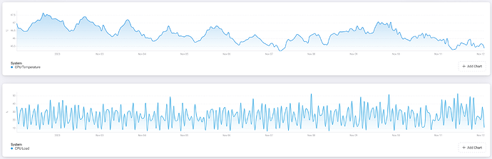

Curious about what the temperature is now and how much load, I updated mine too, similar way (replaced cm4, cooling pads and cooler), and it’s lots cooler indeed.
Here are my stats now (ledring off)
