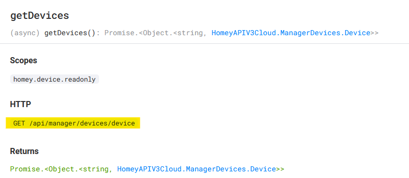

Example: Get device list:
Take the URL for REST API:
