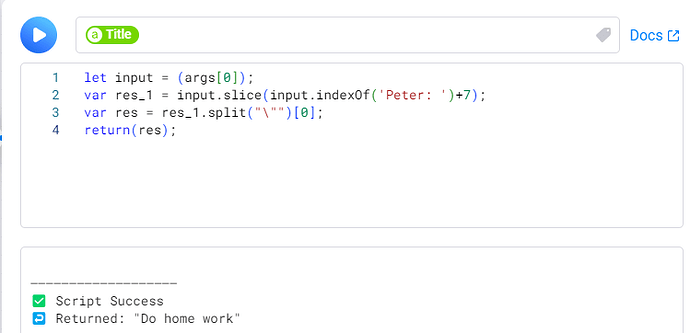

Hi Esben
// Strip name from event
let input = (args[0]);
var res_1 = input.slice(input.indexOf(';')+1);
var res = res_1.split("\"")[0];
return(res);

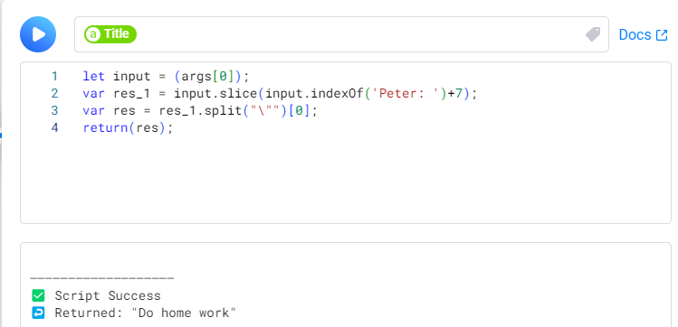

Thank you very much!
I dropped trying to create a dynamic function in which I could just change the spliced input and instead hardcoded the function to the specific name.
It works like a charm now :smiley:
