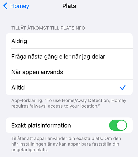

I use iPhones and have the exact position on for Homey app :+1:
The geofencing radius is not adjustable in the Homey build in “Home/Away detection”.
