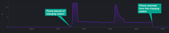

I guess the problem depends on the used smartphone. I have an iPhone 12 Pro Max, use also an and inductive charging station and the phone uses still approximately 2.3 - 2.5 Watt if it’s fully charged. This is the insights graph of last night:
This is how it looks for me, with a Samsung Galaxy S21. After the initial charging phase, I have these spikes with drops to zero in between. Which is weird because the station has a LED which is only active, if a phone is placed on it. Surely, such a LED doesn’t need much power, but definitely more than zero.
Anyway, can’t create a flow with this data. Maybe I just try it with “Alexa, Good Morning”^^
The precision and measurement of the power values also depends on the smart plug itself. Some smart plugs have the option of changing these parameters in the settings. The Fibaro Wall Plug I use measures the power values and the change in power very accurately and with a short interval.
Maybe you can adjust some parameters of the smart plug or use another one.
