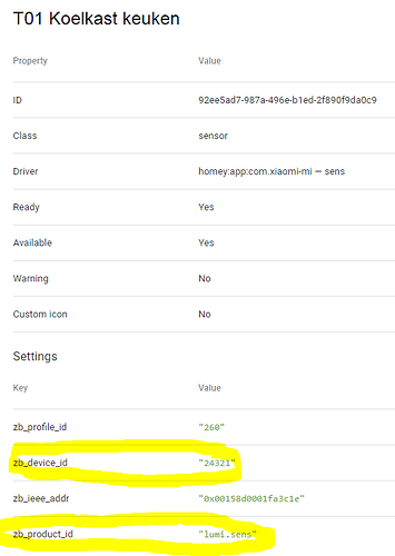

Does anybody know if (and how) i can retrieve the “zb_device_id” or “zb_product_id” with js?
I want to check for this to determine what to display on the tile.

So if i can retrieve the device id i can query this in the first IF statement of a device and write code for each device without interfering others.
The device.id can be retrieved see: line 495 for example.
If you make a condition in the renderDevices function that checks for a certain device.id you can then add the capabilities you’d like to add per device. That would however make it very specific for your environment but if you’re not distributing it that would’t matter (until you remove or add devices :wink: )

Yeah, that one i already found. But that is the unique device ID. I mean the product or device id that is stored in settings section and is visible on the device page. That specifies a range of devices (f.i. all Xiaomi round therm./humid sensors) so you can build a tile around that.
