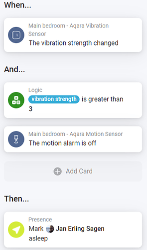

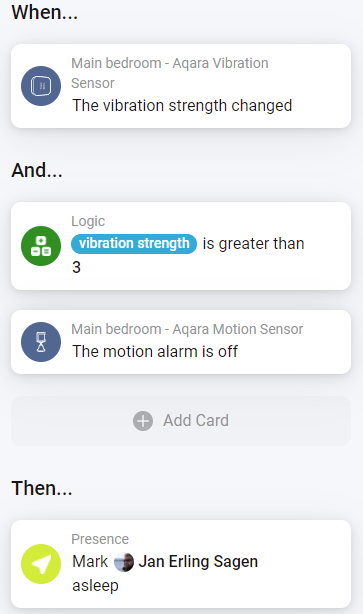

And a second one where the motion sensor sets me as awake if it is triggered
Can you share how reliable this works for you ? I’m having recently issues with Aqara Vibration sensors not updating their Vibration strength values…
It works very well. Except once this summer when battery level probably got to low and since I away on 3 week leave, I had to re-add the device.
