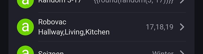

Thinking maybe a solution is using logic that updates with the rooms checked. I am using this flowcard for the automatic cleaning at work. So I’m thinking if it is possible to make the entered rooms a logic that gets it numbers from user input somehow it should solve the issue?
If the card takes tags/variables as value:
You can try to use a text variable instead, and see what happens when you test run the card
Something like:
Thanks. The card takes tags/variables but I still need to update this variable from user input about which rooms it should clean. Is there any app or solution to fixing this?
I’m thinking about a dropdown menu or a list where you can highlight wich rooms you want to clean and then confirm which sends the desired room numbers to the variable.
