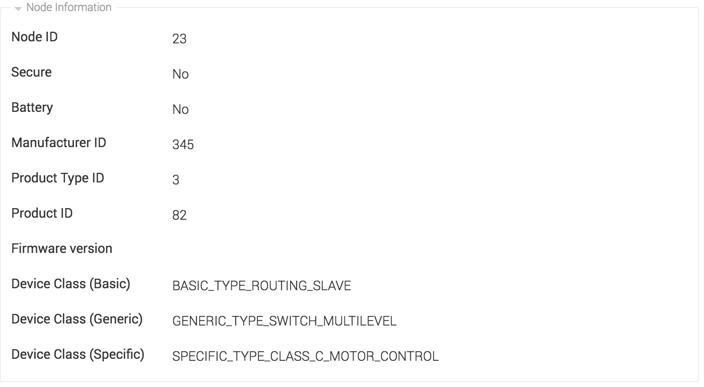

I’ve de-coupled them from the Honeywell controller and paired a couple with Homey to test them, but they’re only detected as an unknown Z-Wave device. This is fine for turning them on or off, but they also support dimming and I’d like to try my luck to get this working too.

@HighwaymanEd Environexus are a brand sold in Australia - all of their Z-Wave devices are simply re-branded (OEM) devices from other Z-Wave manufacturers. So the trick here is to find out which device they have re-branded - and then (hopefully) find the appropriate Homey App for the manufacturer.
I believe that in the past, Environexus have used both Aeotec and Qubino modules - Interestingly though, I do not recognise the form-factor of the device you have posted a picture of (although it could be the Qubino Flush Dimmer - I would try Qubino App - also, I note that you have posted a picture of a relay which is on/off only, however I will assume you have a dimmer version) - so it makes it a little difficult to match (for me anyway)! So we need to find another way identify the module…
We get some clues from the Manufacturer & Product IDs - usually we can search the Z-Wave Alliance Certified product list to find the product - Unfortunately I do not believe we can search by Manufacturer or Product ID (I could be wrong) so it would me a matter of hunting around until you hopefully find a match.
