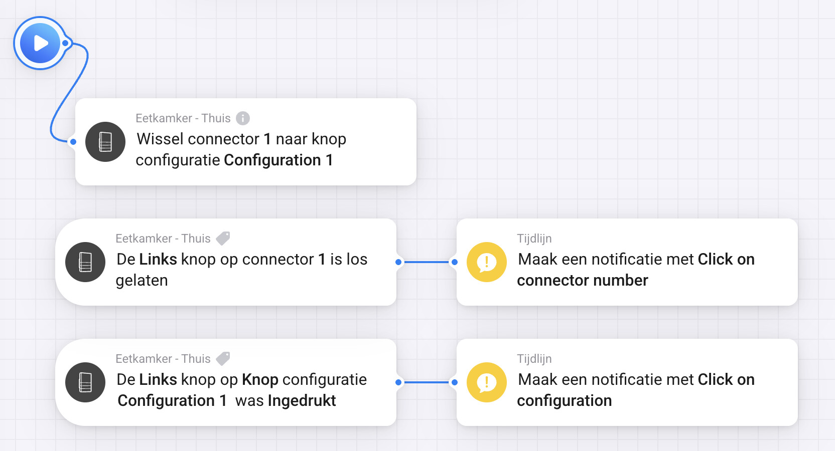

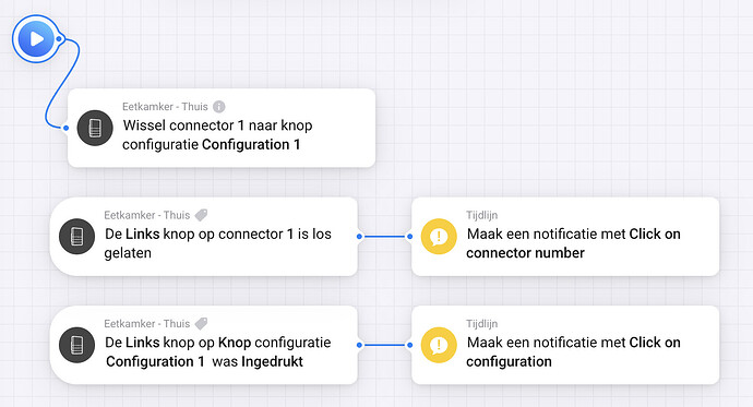

He, I’m struggling to get the ‘Congfiguration X was Released/Pressed’ card to work. I removed the application and added my button+ to have a clean install. But it still won’t trigger on this card. Any idea why this card won’t trigger?
The card that checks on connector number does work as expected. Tested on firmware 1.13.2 and 2.0.0. Both firmware versions have the same result.
Thank you!
Flow:

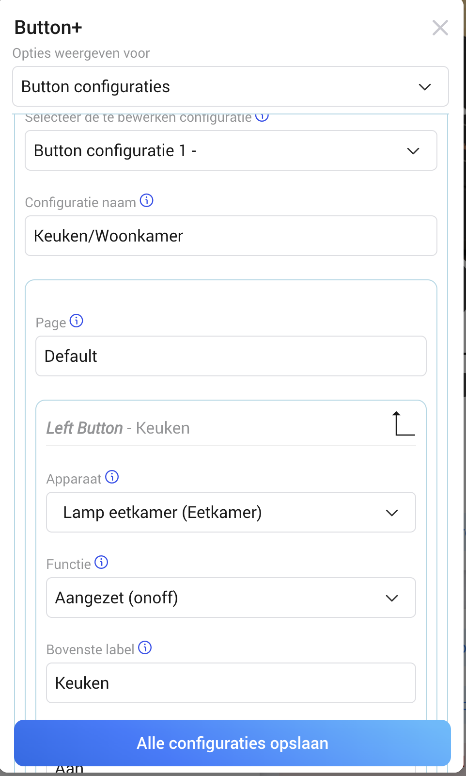

Button configuration:
Logs:

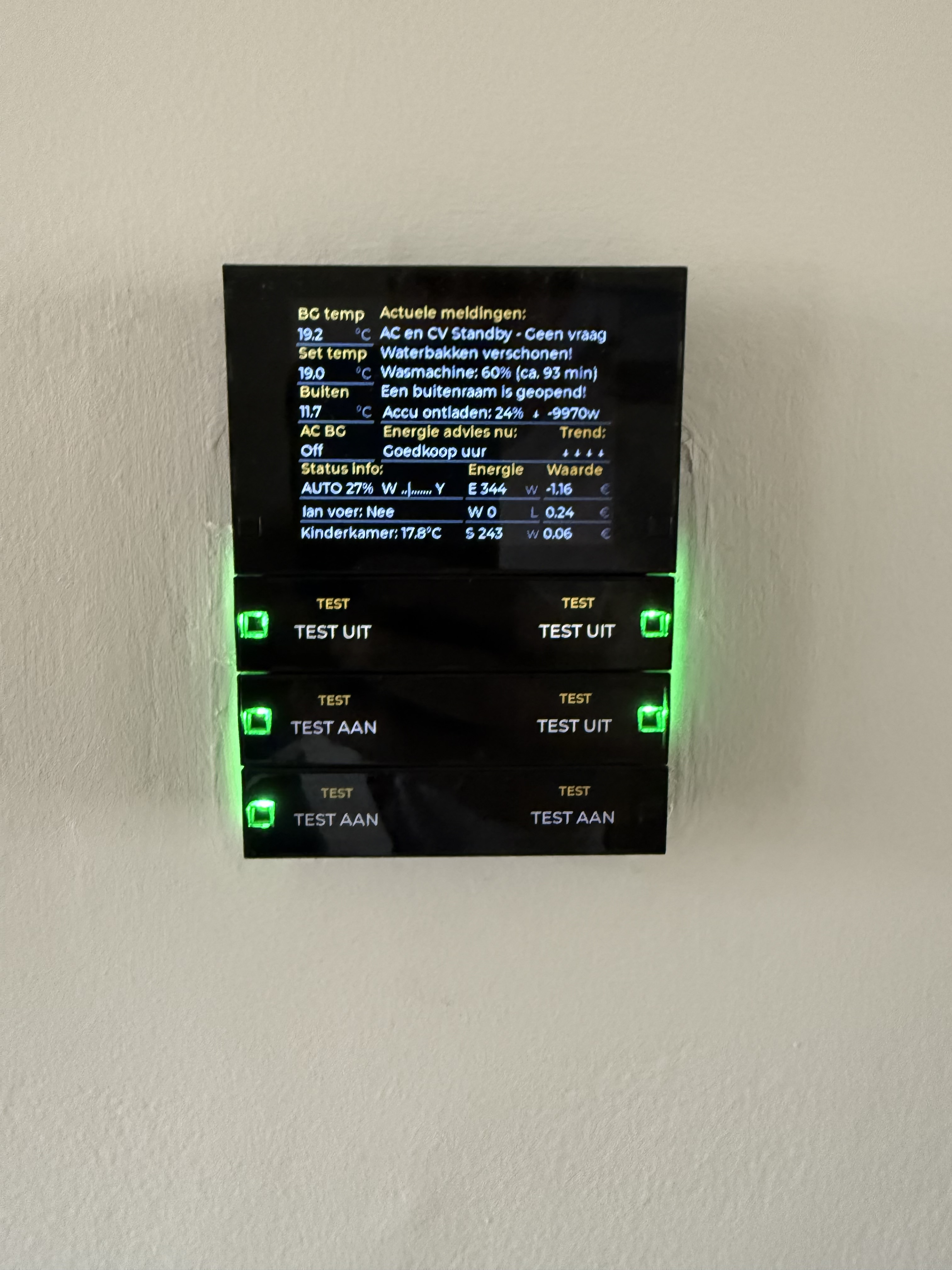

I have tested extensively but am still stuck on setting led colors on row 4 right button (front and back).
No matter what I do, row 4 right (if built with 4 modules (display and 3 rows of buttons), I get the bottom row right button no front or back LED on. (Latest 1.x firmware)
New display module, 3x buttons, new motherboard, none of it makes a difference. Do I build it with 1 display and 1 row of buttons then I can control the bottom row on the right. This firmware has worked fine here for an extended period of time. Anyone have any idea what is going wrong? Thanks for everyone’s time and help!
Ps. When I use the flowchart ‘set front and back (both) to a color; then it is not working on any button bar. But front of back individual is working on other button rows.

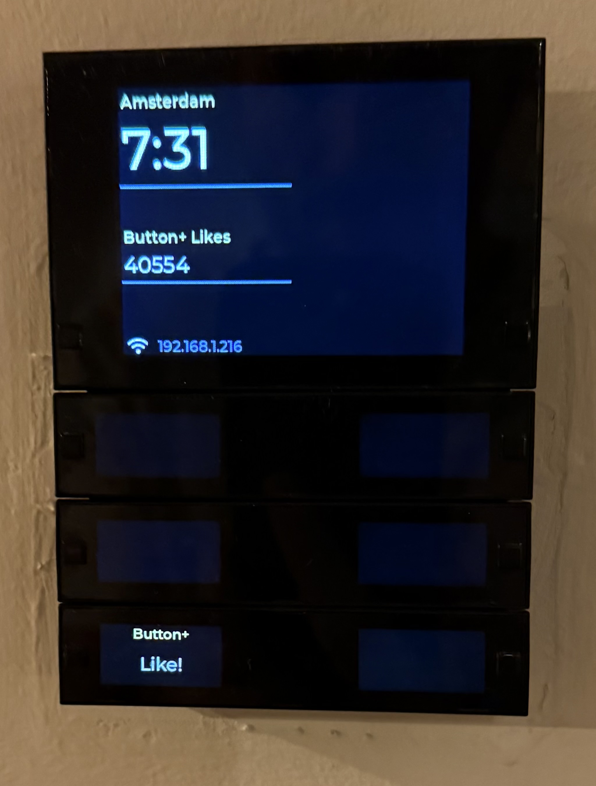

  2. I don’t like devices as this with direct internet acces. In 1.x I can block this. In 2.x I then get wifi error messages and I saw several times (in 2 days of testing) a screen with time and number of likes. The buttons then became a +like button. I don’t particularly like this. (Especially not after my predecessor, a smpl display, suddenly seemed to show propaganda from Ukraine. (Turned out later to be a hidden future - don’t want to make political statements, but in the house I find it very unpleasant when the whole family/visitors can suddenly see this kind of text and I feel forced to apologize or explain.
  3. The screen has to reload continuously in version 2 (complete refresh). This is not needed in 1.x.

I see that the LED can indeed be controlled again in the 2.x software. (Though again the ‘both’ (front and wall side together does not work).
What I saw frequently in the 2.0 firmware (which makes me happy to stay with the 1.x) is this screen.
For me the issue’s were solved in this combination of firmware and app version’s
This is because of the default config connecting to the mqtt server of button+.
As @Torch1969 says, that is the default configuration that just connects to the Button+ MQTT broker. Once the app takes over it completely overwrites that configuration and is completely local (unless you manually setup an external MQTT broker). I have access to the Button+ source code and I can assure you there is nothing dodgy in there. If you see that screen after setting it up in the Homey app, then there is likely something wrong as it is getting a factory reset.
I agree with you on point 3 and is my only dislike of the new version. However, some of that can be overcome by embracing the new paging feature of the buttons instead of switching configurations.
