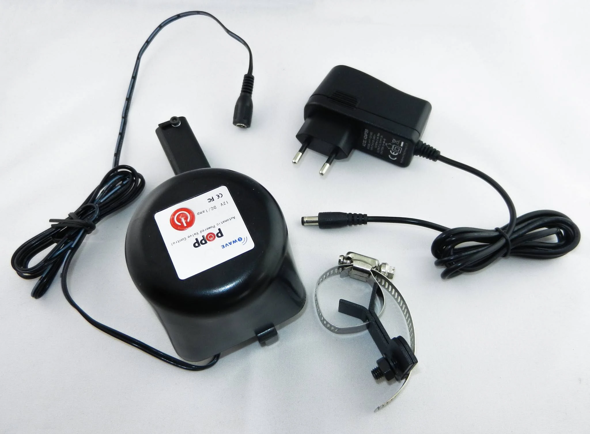

I made myself an automatic chicken door by using a Popp Valve Stop.

I used nylon rope … this will stay for a very long time. Stainless steel cable was not flexible enough for the very light door (cutting board from Action).
