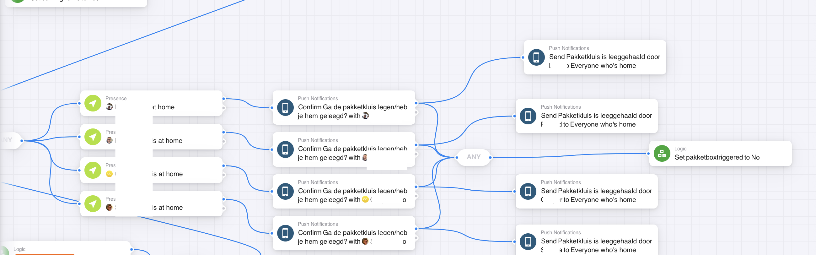

I did it now like this:
Before that pictue is the trigger: someone comes home.
