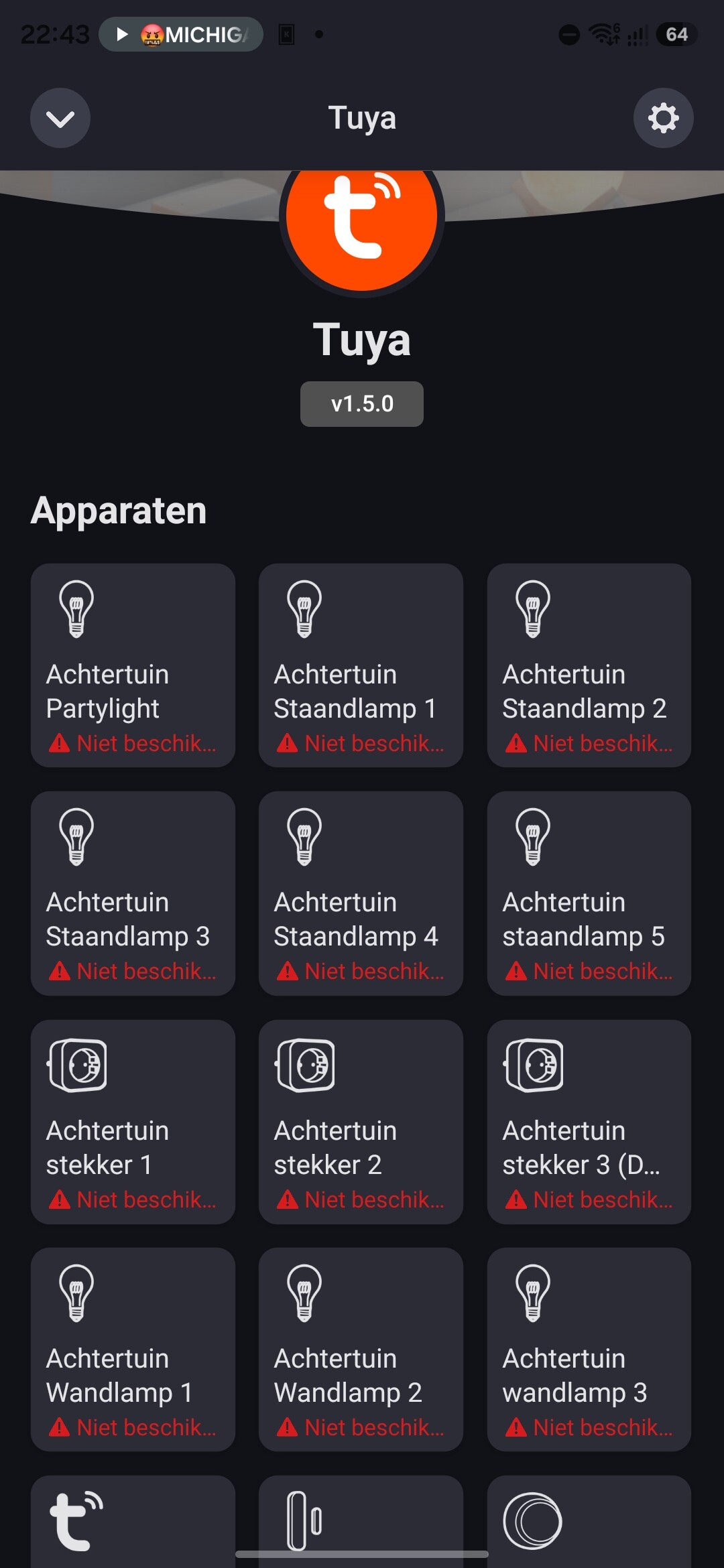

I am having the same problem as some others. My devices randomly stops working and are “unavailable”. It can happen 1-3 times a day.
Repairing works sometimes but sometimes it doesn’t. Restarting Tuya app makes everything go crazy.

So I tried repairing devices again but restarted Homey. This time it took nearly 10 minutes to fully boot and connect with the Homey. It took a few tries but eventually it worked again.
