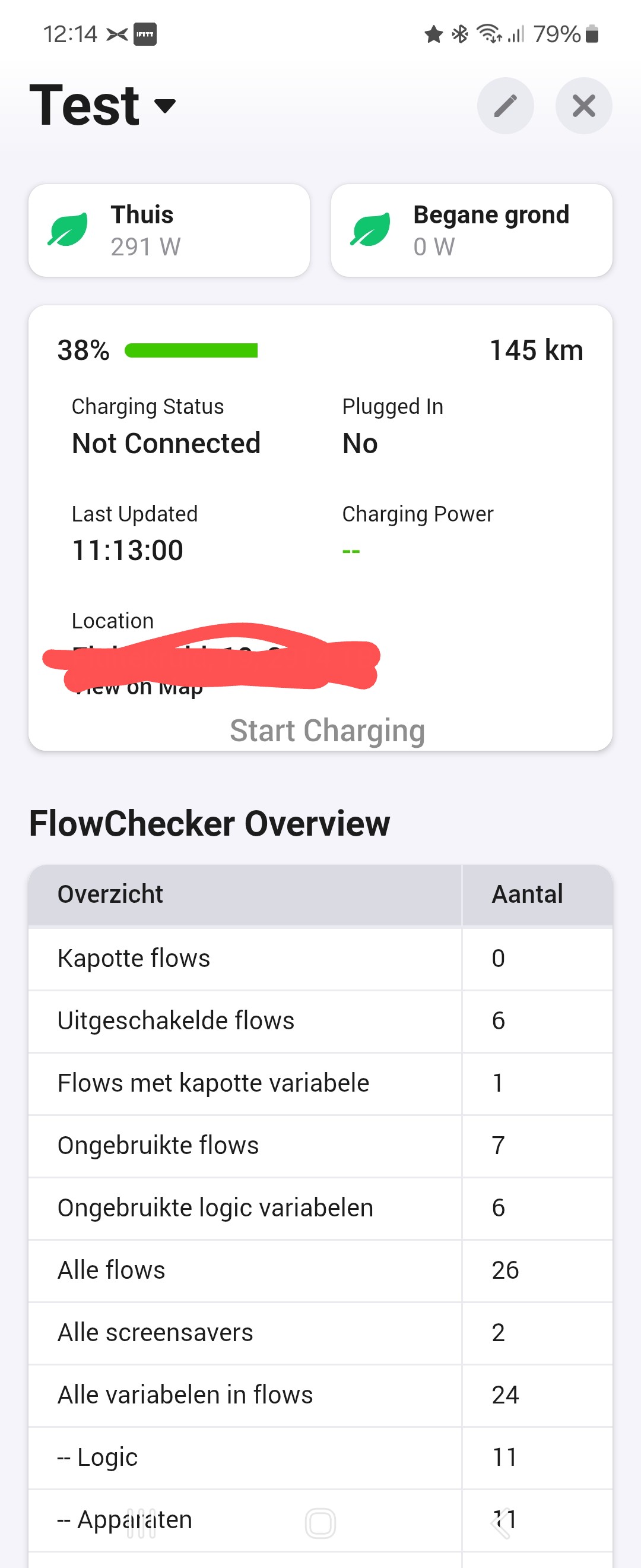

  1. in the mobile phone dashboard (android) the button ‘Start Charging’ is well visible, while in the tablet dashboard it is dropping below the widget area.
  2. The ‘Start Charging’ button is greyed out , maybe because the car is not plugged in according the widget, while it os , that is the Enode API terrible delay and not updating change of status, but when I start charging via a manual flow the ‘Start Charging’ is no longer greyed out , but when you press , you the API error , which make sense as already charging. Maybe Idea to have start and stop button next to each other? It would be cool as that will already unlock the plug from te car when I’m approaching if I stopped it from the dashboard when leaving home.

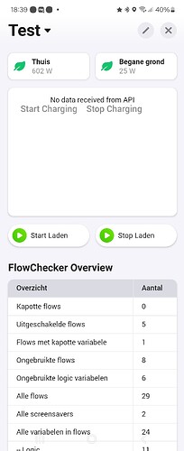

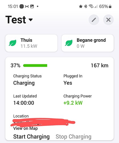

For some reason when start charging request I still get the aborted screen. Looks like my wallbox charger needs to be unlocked so will test more so perhaps more internal issue. But once it is charging the stop charging stays greyed out and start charging is “active”.
the stop start button is now fixed and greyed out when charging.
But if your wallbox prevents start charging then you will see a error.

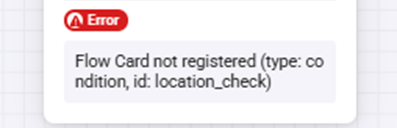

Hi, getting an error when using the “AND” car is within xxx m of coordinates card

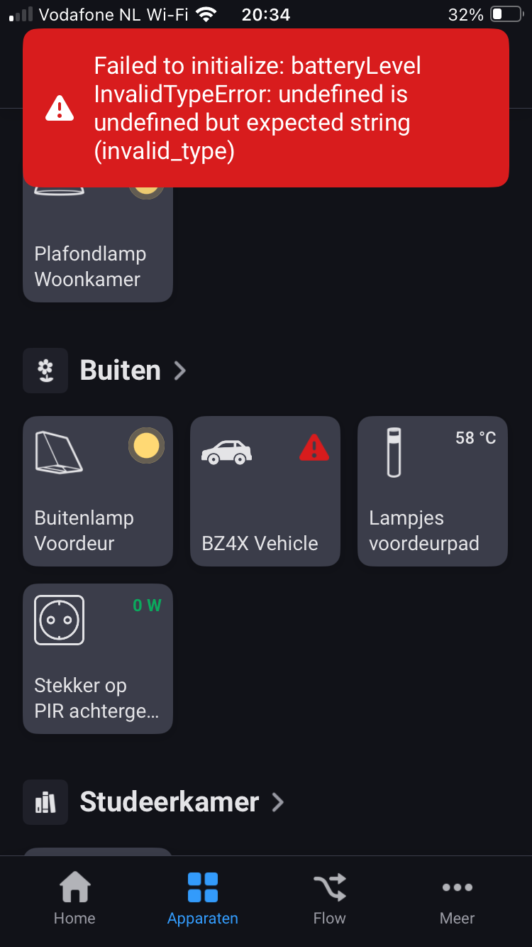

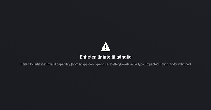

Hello @Kjetil_Vert. After the latest update of the app (1.2.38) I lost connection to my car and I now get below failure message. Well, I can’t say for sure that is connected to the app update but it seems so. Connection has worked flawlessly before.
For me the app stopped working today after the update. I use it for the Toyota BZ4X so I don’t know how it works for XPENG cars, but I would appreciate returning to the previous version. Update: i installed version 1.2.36 (i was on 1.2.38) and that solved the problem).
