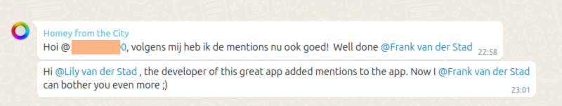

@martijnpoppen It is working buuuutttt I saw one small thing. If you enter a comma directly after the phonenumber to mention, it is not working:
For now, this is no issue. I create the messages myself, so I can just prevent it from happening (just a space between the number and , will do!!)
Thanks again for the great work!
@Frekel oh yeah correct I take the whole text just behind the @ so it won’t validate it properly with the comma indeed.

For now I have this in my flow, so I am all good :wink:
Screenshot from 2024-10-08 23-27-47
So I am running a replace “+” → “@” and add a space after the senders number and use that for my mentions!
