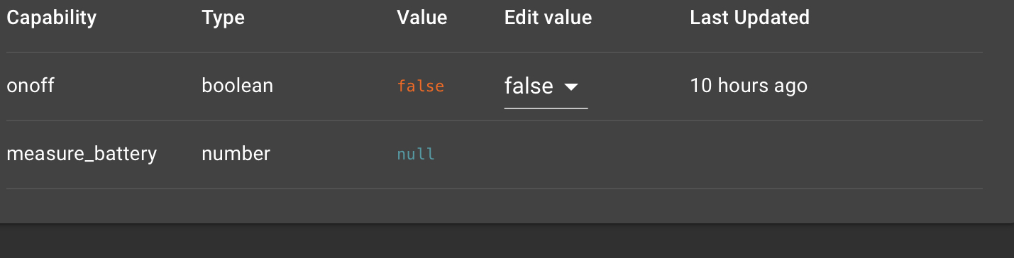

Form me it (battery status)worked fine in V4
@Peter_Peter You already tried to re-add device right?
today i will also try to re-add the siren
Yess multiple times yesterday (not with .24)
@martijnpoppen, no battery status after re-add
V2.0.24

Now the device shows 70%. Is this because i gave the command via developer tool? :slight_smile:
Looks like it.
The response you got is the way how the app picks it up. So look like a you gave it a ‘kick’.
Maybe there’s a way to do this on startup of the app…
Just looks like the siren just never sends its own battery level, might also explain why it was always empty as Homey only asks by default for the battery level if the device wakes up.
A FLIRS device like this siren though doesn’t wake up, so by default the level was never retrieved.
