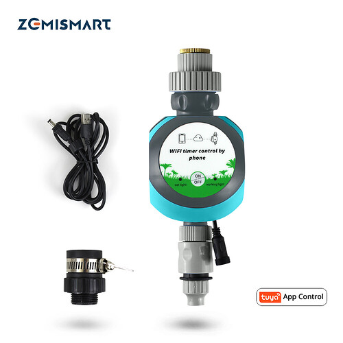

F.ex I have a DELTACO water valve, identical to this one from Tuya:
I’d like to be able to control this from Homey, has anyone tested? I don’t need any of the Tuya/DELTACO features, I just want “On/Off” from Homey.
