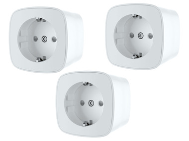

  "ids": {
    "modelId": "TS011F",
    "manufacturerName": "_TZ3000_gjnozsaz"
  "endpoints": {
    "ieeeAddress": "a4:c1:38:55:7f:df:7a:20",
    "manufacturerName": "_TZ3000_gjnozsaz",
    "capabilities": {
      "type": "Buffer",
      "data": [
        142
    "endpointDescriptors": [
        "status": "SUCCESS",
        "nwkAddrOfInterest": 44976,
        "_reserved": 30,
        "endpointId": 1,
        "applicationProfileId": 260,
        "applicationDeviceId": 266,
        "_reserved1": 1,
        "inputClusters": [
          3,
          4,
          5,
          6,
          1794,
          2820,
          57344,
          57345,
          0
        "outputClusters": [
          25,
          10
        "_reserved": 10,
        "endpointId": 242,
        "applicationProfileId": 41440,
        "applicationDeviceId": 97,
        "_reserved1": 0,
        "inputClusters": [],
        "outputClusters": [
          33
    "touchlinkGroupIds": [],
    "extendedEndpointDescriptors": {
      "1": {
        "clusters": {
          "identify": {
            "attributes": []
          "groups": {
            "attributes": [
                "acl": [
                  "readable",
                  "reportable"
                "id": 0,
                "name": "nameSupport",
                "value": {
                  "type": "Buffer",
                  "data": [
                    0
                "reportingConfiguration": {
                  "status": "NOT_FOUND",
                  "direction": "reported"
                "acl": [
                  "readable",
                  "reportable"
                "id": 65533,
                "name": "clusterRevision",
                "value": 2,
          "scenes": {
            "attributes": [
                "acl": [
                  "readable",
                  "reportable"
                "id": 0,
                "acl": [
                  "readable",
                  "reportable"
                "id": 1,
                "acl": [
                  "readable",
                  "reportable"
                "id": 2,
                "acl": [
                  "readable",
                  "reportable"
                "id": 3,
                "acl": [
                  "readable",
                  "reportable"
                "id": 4,
                "acl": [
                  "readable",
                  "reportable"
                "id": 65533,
                "value": 2,
          "onOff": {
            "attributes": [
                "acl": [
                  "readable",
                  "reportable"
                "id": 0,
                "name": "onOff",
                "value": false,
                "acl": [
                  "readable",
                  "reportable"
                "id": 65533,
                "value": 2,
                "acl": [
                  "readable",
                  "writable",
                  "reportable"
                "id": 16385,
                "name": "onTime",
                "value": 0,
                "acl": [
                  "readable",
                  "writable",
                  "reportable"
                "id": 16386,
                "name": "offWaitTime",
                "value": 0,
                "acl": [
                  "readable",
                  "writable",
                  "reportable"
                "id": 32769,
                "acl": [
                  "readable",
                  "writable",
                  "reportable"
                "id": 32770,
                "acl": [
                  "readable",
                  "writable",
                  "reportable"
                "id": 20480,
                "acl": [
                  "readable",
                  "writable",
                  "reportable"
                "id": 32768,
          "metering": {
            "attributes": [
                "acl": [
                  "readable",
                  "reportable"
                "id": 0,
                "name": "currentSummationDelivered",
                "value": 0,
                "acl": [
                  "readable",
                  "reportable"
                "id": 512,
                "acl": [
                  "readable",
                  "reportable"
                "id": 768,
                "acl": [
                  "readable",
                  "reportable"
                "id": 771,
                "acl": [
                  "readable",
                  "reportable"
                "id": 774,
                "acl": [
                  "readable",
                  "reportable"
                "id": 65533,
                "value": 1,
          "electricalMeasurement": {
            "attributes": [
                "acl": [
                  "readable",
                  "reportable"
                "id": 1285,
                "name": "rmsVoltage",
                "value": 231,
                "acl": [
                  "readable",
                  "reportable"
                "id": 1288,
                "name": "rmsCurrent",
                "value": 0,
                "acl": [
                  "readable",
                  "reportable"
                "id": 1291,
                "name": "activePower",
                "value": 0,
