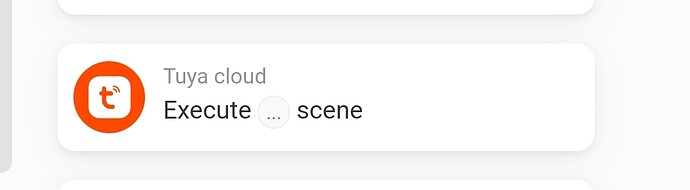

I have solved the issue above temporarily by making a scene in Smart Life and calling this scene in my advanced flow with the then card ‘start legacy scene’ with the Tuya cloud app.

The card ‘Execute scene’ is aimed at the iot official API and should work when you set everything up per instructions @ post #1

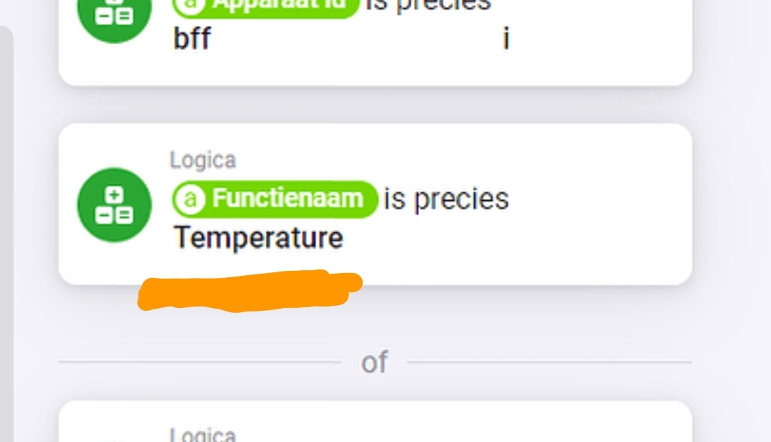

@MikeyB Keep in mind, Logic cards “[tag] is exactly …” are case sensitive. So a T is not the same as a t

My apologies, I was sleeping. I’ve managed to get the sensors working. I’ve also got the blinds working. I’ve even managed to set it up so that a double press on the physical button triggers a flow and the blinds come all the way down. I can also control the air conditioners using the Tuya IR device through “execute scene.” I just need to figure out how to transfer the IR device from Tuya to Homey. So that I can fully control the air conditioner in Homey. The strange thing is that my IR device in Tuya has created an air conditioner, but I can’t find it in the Homey app.

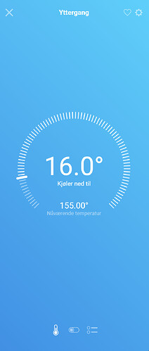

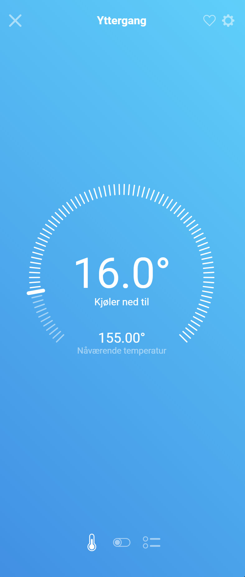

The temperature is displayed incorrectly in Homey. When the measured temperature in the thermostat is 15.5 degrees, homey shows that the temperature is 155.00 degrees
