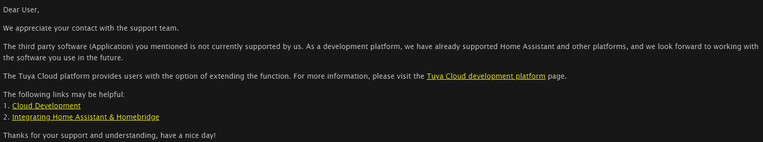

I also asked Tuya if they are planning to support Homey. This is their answer;

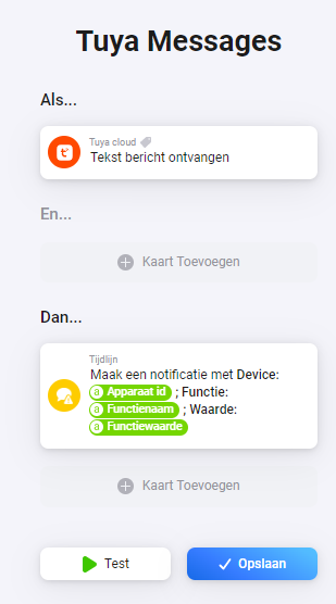

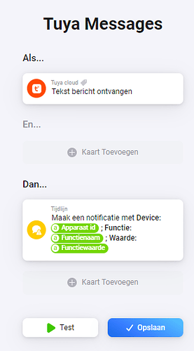

It looks like your Tuya IoT cloud is fine and your Tuya app on Homey is receiving raw messages, but something within the Tuya app on your Homey is not communicating the values to your devices. To check this, try this simple flow:
Once you enable this flow you will get timeline messages in your Homey App on your smartphone like this:
Don’t keep it running too long, you may get a lot of timeline messages!
