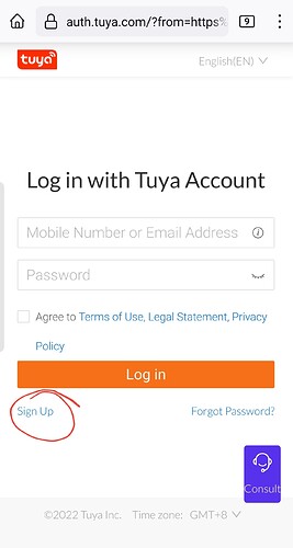

I tried to make use of the new API but I have a problem. I only have a smartlife account. How do I login with this in tuyacloud for Tuya iot platform configuration?
Thanks,
Erwin
Hi Erwin, use the ‘sign up’ link below the login fields.
Afaik you can use the same email address of your Smart Life account, but not the same password.
Thanks but by this I make a new account. I want to reuse the already coupled devices in Smartlife. Is that possible?
Yes. During the setup, you’ll allow the iot project to read/write your Smart Life devices. Don’t change anything with your Smart life account.

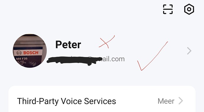

i follow everything these pages say, still get the massage:“Error code 2406 msg skill id invalid”
What is the problem?
Or
Did you enter the SmartLife or Tuya Smart email address at ‘USERNAME’? (And not your user name literally).
If that doesn’t help, change the password of your SmartLife or Tuya Smart account, and try again.
Netherlands = Central Europe V
Creation Time : 2022-08-17 11:07:29
Tuya smart emailadress V
