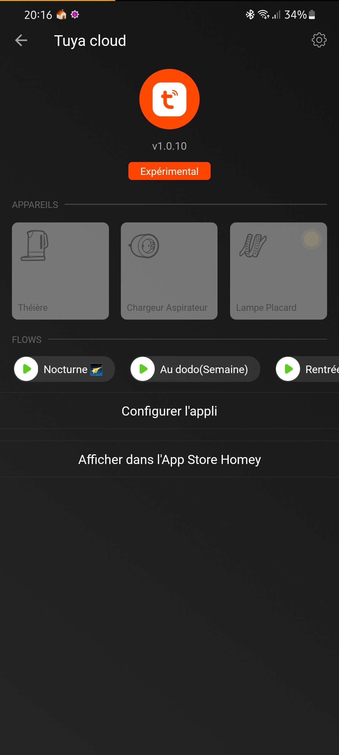

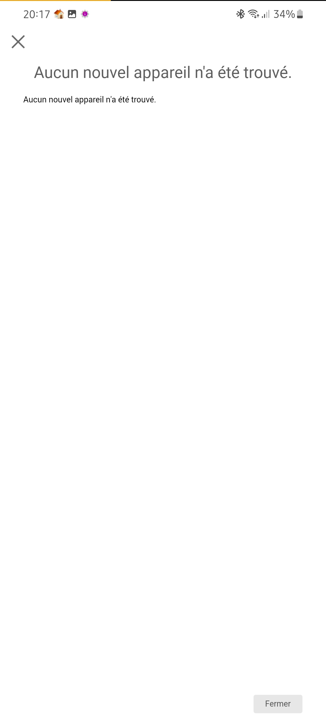

Still can’t add my contact sensors with the last update…don’t know why…
Ewen, Can you double check the version in your app settings on homey? Can you copy the message your getting?
It’says “no new devices found”

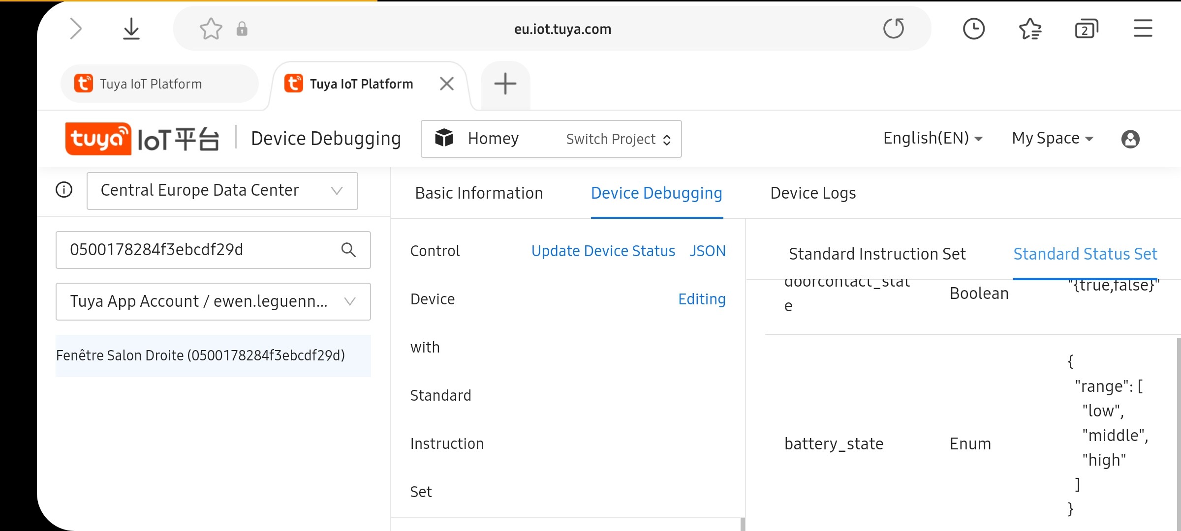

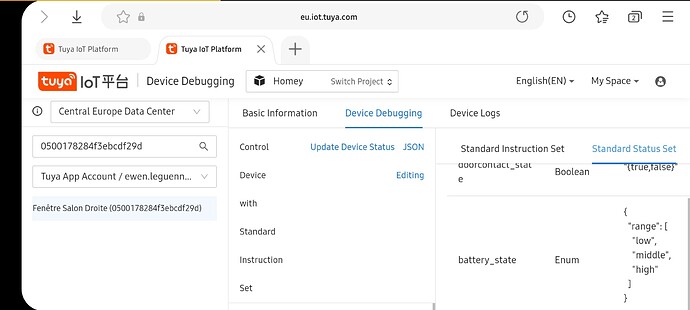

They appears in Tuya IoT Platform Configuration
Can you check on the device debug information to see if you can similar result as this: Just to check if the device is recognized as contact sensor:

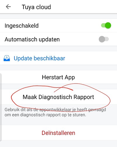

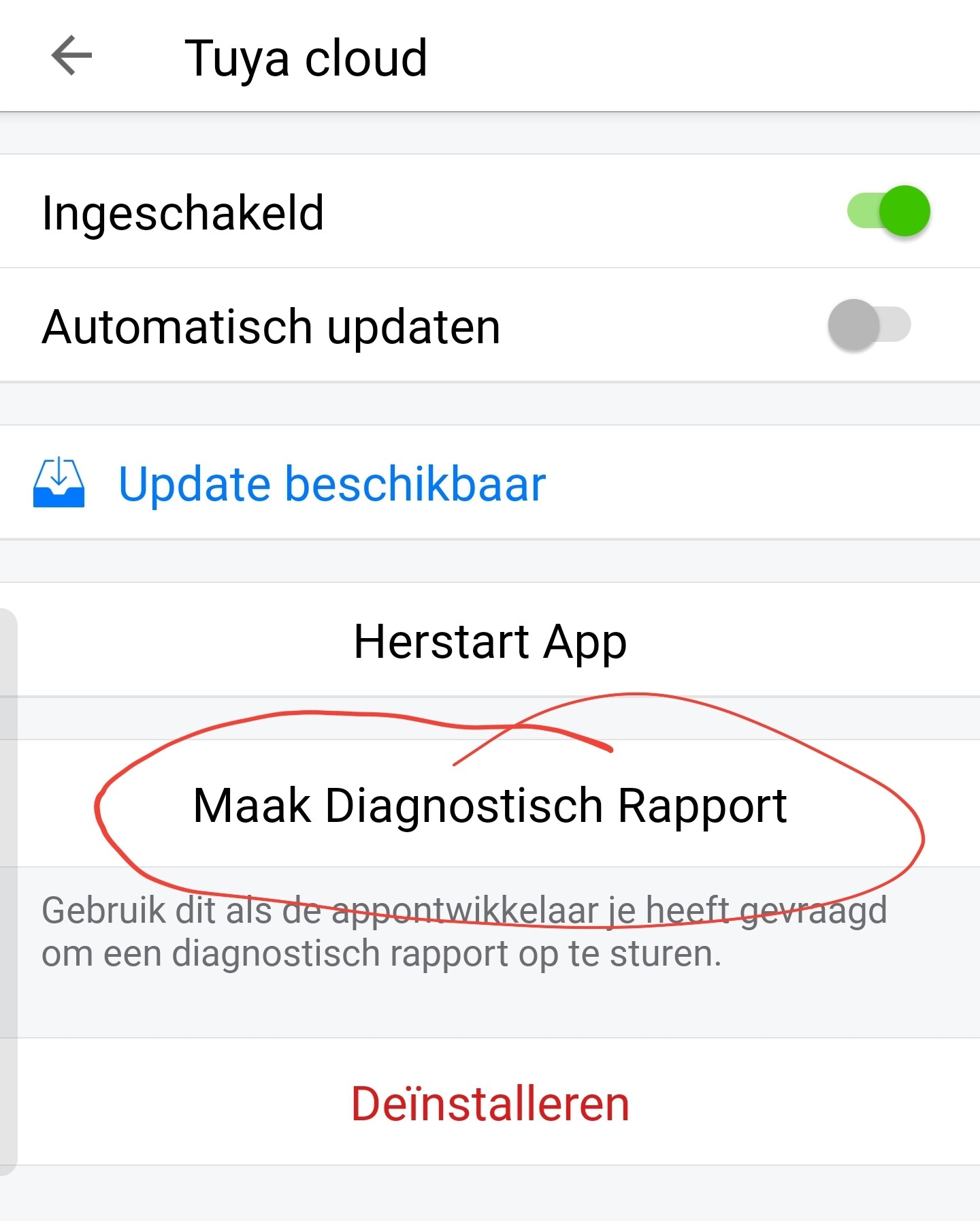

Thanks to try to helping me,but i don’t know how to create and send a diagnostic report…
Mobile app: …More > Apps > Tuya Cloud
Then hit the gear wheel on the top right
Then:
Send the returned number to Jurgen
Enter your forum name in the report description.
