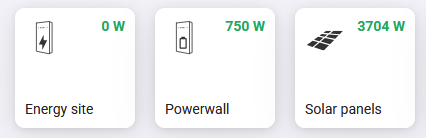

New test version: 3.1.0:
  • Addes Tesla energy site (inverter, powerwall, solar)
Tesla changed their Firmware for energy site and local access doesn’t seem to be possible now.
But energy data is also included in FleetAPI. So this app just uses FleetAPI to import energy data into Homey.
Add the energy site device first (it handles the API - like the car device).
Then add battery/solar device, These separated devices are needed to show the data in HomeyEnergy.
Currently only live data is supported.

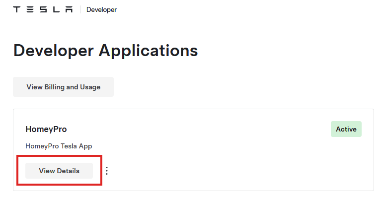

Hi i am pretty new here. I just installed the Tesla plugin to connect my Tesla. I made a developer account and that looks oke to me. But after the step client ID and Client Secret, I get a 403 forbidden Unauthorized missing scopes on my phone. In my Tesla account i have the Homey 3 party app. I have the multi factor authenticator option on on.
Hope you can help me.
Which version are you using, live or test version?
Please check:
  • In developer dashboard where you created the app (client_id) please check the scopes. Activate at least the profile and car scopes.
  • In your normal account under 3th party apps, please check that you set the same scopes.
If that does nor work, remove 3th party app and proceed the repair process in Homey device repair view (login). Contiue the views (client_id is prefilled) to login screen. There you can again set the scopes and the 3th party app is assigned again to your account.
Adjusting the scopes at developer en account did the trick.
Thank you for de rapid respons !!
Robert
Thanks I also had issues I had the scopes selected but was getting the same error. I simply removed the whole Tesla app and then re added it to my homey. As I went though the API it asked again for the scope and now it’s working.
@RonnyW your are a life saver thank you for the work you do
For all with ‘scope missing’ error after updating scopes in developer account:
I think it needs a re-login to update the session to use the new scopes. I try to provide a repair function to force a re-login to update the scopes.

Version 3.1.2 is now live:
  • Adding Tesla Energy (EnergySite, Powerwall, Solarpanels)
  • This version supports live data only
To add the new devices and adjust your Tesla app registration (adding new scopes), please follow the desctiption on my Blog
