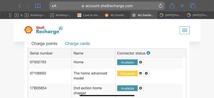

I have the 3.3 update installed and named all 3 chargepoints. But it gives an error again. The second one is in occupied state and offline. I cant reset it from my account so I’ve send an email to shell to support the reset of the chargepoint or delete it from my account.
Hope this helps.

I’ve named all of them. Can you please check which serial no/name does import correctly and which one gives an error on import then I can remove the one which still gives errors from my account.
