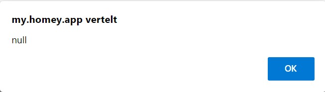

Hello, I have a question about adding the device in the homey app. I do have a shell account and 2 registered cards. but when I’m adding the device I receive an error after selecting the attached car and one of the two charge cards. in android it says:
dutch ā€œEen onbekende fout is opgetredenā€ / english ā€œAn unknown error has occurredā€
in Windows is says: (see picture)

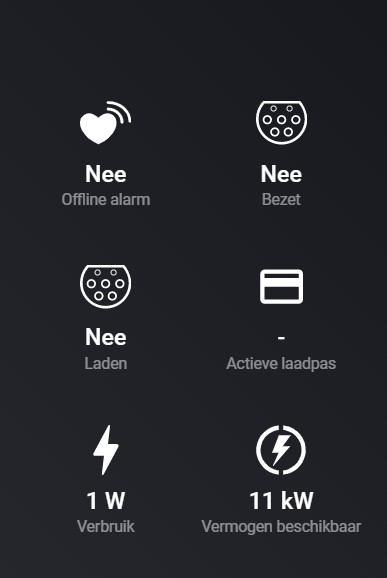

the device is added but I’m missing the charge card information: )see picture 2)
is there something wrong on my side or could it be something else?

Hello Kaoh,
I have two cards and one car.
Diagnostic report: e62b6114-e7e5-42dc-8f2d-e72100d62112
The active charge card is not available in the app (see picture I send before), al other features are working properly.
AndrƩ
The picture above is without an active session, charging is no, then we never show a card.
Only when the session is active will it show, so the car must have turned the light blue. While teal, connected but not active its not shown.
So please check ik it while your car is drawing power.
yes, you are right about this. I do see the active card when it’s charging. but I was confused when I saw the error when adding the device. but it works fine. thank you.
in Windows I see this, when adding the device. but it’s available in the app afterwards.

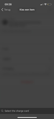

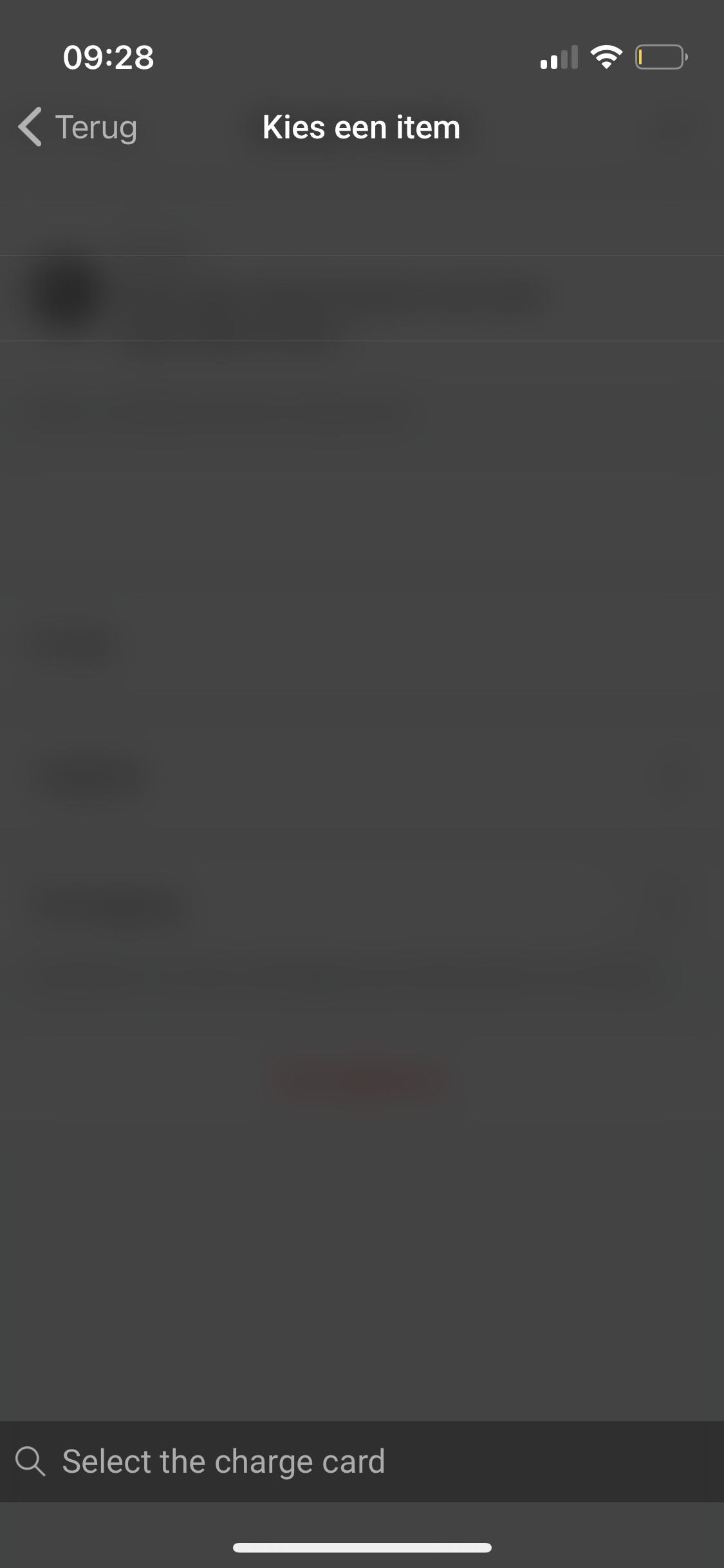

When i install the app, i can choose the card and car.
But in a flow i cannot select a card…. I can select the car
What goes wrong here?
