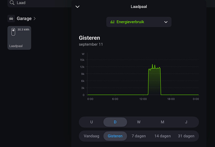

Is there a reason why in the list with large consumers (grootverbruikers) the consumption of the Charger is not updated? I see the consumption in the “Energy usage” graphic so there is no problem with the connectivity.

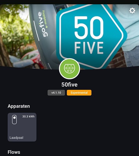

Make sure you have the latest version
Isn’t that the latest version?
That’s it, you don’t get the usage then you probably have to remove and read the charger, it should expose a usage capability that is used by the Homey energy screen. This version supports it already since 4.0 so must be a upgrade failure then
Also check your advanced settings to ensure my custom setting to include in energy is set to true

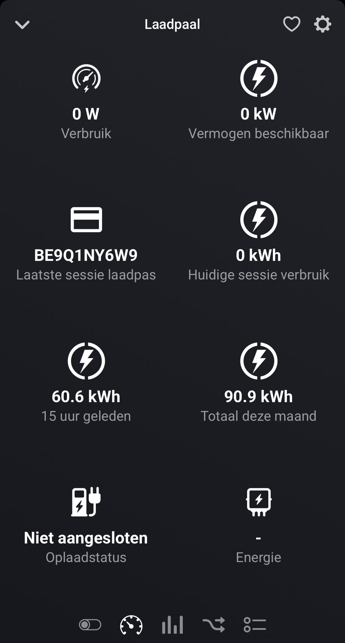

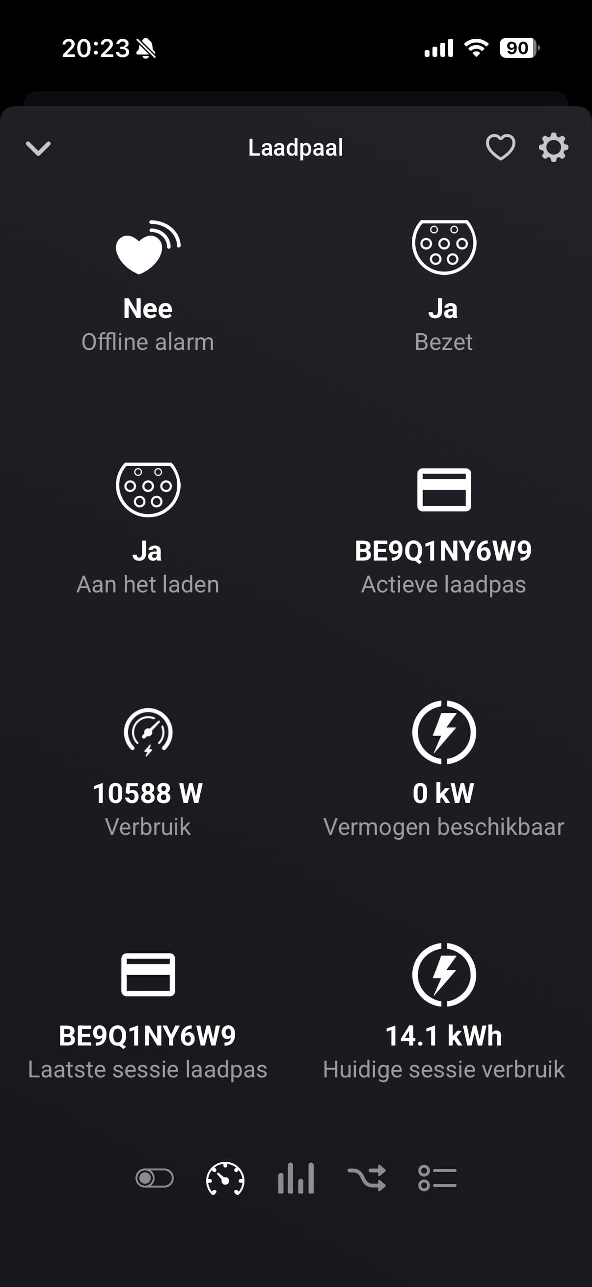

Does your usage (in the device sensors) change while charging actively? Just like the energy sensor?
I see todays usage in the app
The top left one, Verbruik, does it change? So when did it last change right now, how long ago?
That is the value that should be active during a session in line with what your car drains.
I can see the power usage of the charger, but still no change
Indeed all requirements are working, no idea than why it doesn’t show in your Homey. It’s your honey updated to the latest firmware?

Can you check if you have all these capabilities?
Verbruik
Energie
Charging state
Then check in the energy dashboard:
Do you see the charger in the tiles below the house?
Do you see the charging state in that tile and if charing the Verbruik value?
Can you check in your metrics the Verbuik and Energie values for the last day (id charging happend)
Send me that screenshot
I think there is an issue with showing “Energie”. Could that be the problem?
That is weird, indeed that one is required by energy dashboard. That’s relatively old fearure so surprised that it doesn’t work for you.
