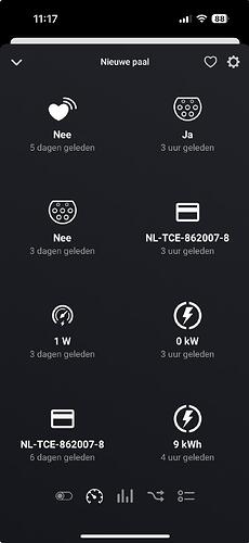

is it just me or is it true that a number of fields are not synced? I reinstalled the app 5 days ago for testing but loading the map now suddenly always stays on no. consumption ditto. I also saw the pole in the energy tab (where it apparently always consumed a little power because the line kept running there) but it has now suddenly disappeared there too. although the consumption is shown in the list of major consumers.
That’s the same issue I am seeing myself. Their api doesn’t provide these values anymore.
I need to figure how to bypass that or we wait for them (shell) to fix it. But with them selling their charger business it’s unlikely they care right now.
that was exactly what i thought too :pensive_face:
