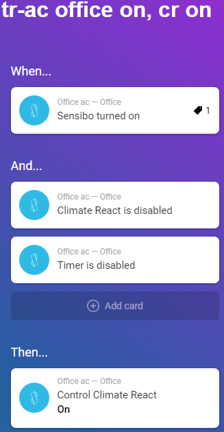

Automatic CR: example flows in Homey
  • As soon as an AC turns on (trigger is Sensibo On), also CR will be turned on;
