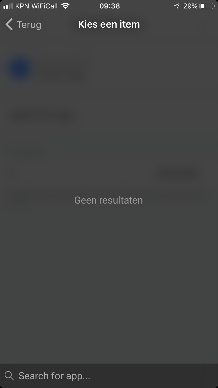

My tv is not finding any apps in de flow…
