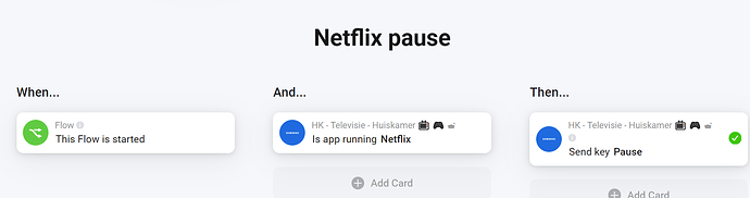

I want Netflix paused on my Samsung SmartTV paused when the doorbell is pressed. I see the option ‘Is app running’ and when I select Netflix and test it it’s also triggered when the TV is off or is showing cable.
Is this a known issue or am I doing something wrong and need to have another trigger/card?

the condition doesnt work for me either. I have very easy flow:
But as with you, live tv pauses too…
One problem is fixed the IP changed and gave it a fixed IP… But I still get a red exclamation point when testing and Netflix is running!
Changed it to prime video and the same problem. It just pauses. @balmli you have any clue?
Thanks for the testing! And when it gives an error it just skips the AND part and do the THEN part anyway… I think it’s an issue with the ‘app running’ and when it gives an issue it just skips that part?
BTW @Martijn_Hoogenbosch which online editor do you use for this flow screen?
Well, it doesn’t even give me an error. It just tries (something) and skips. There is neither a exclamation mark or check mark.
It’s the webapp with the three column layout as suggested in the topic of the webapp.
On the Homey app on my phone it did gave an exclamation mark so maybe that’s the difference but either way it skips the field and doesn’t check which app is running…
But for now we can only wait for a reaction!
Created an issue on his github: Condition card 'app is running' doesn't seem to work · Issue #28 · balmli/com.samsung.smart · GitHub hopefully there is a way to get this sorted.
