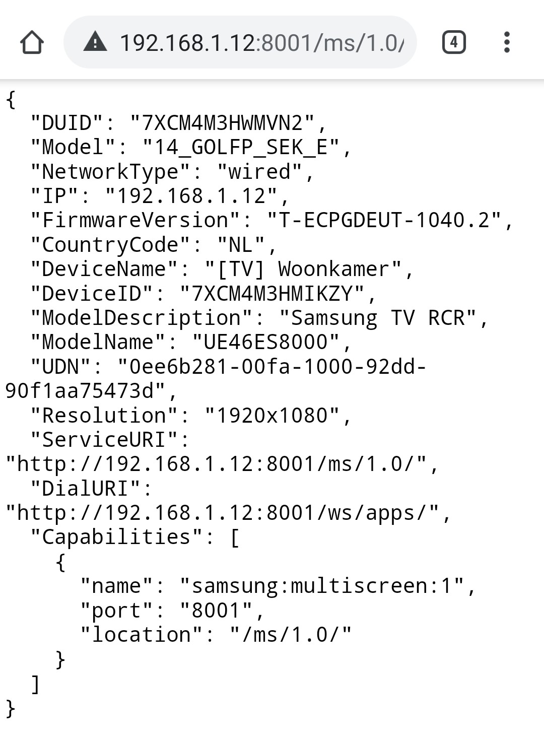

Still fuzzing with my UE46ES8000 with SEK-2000 Evolution kit.
The Evolution kit actually upgrades this 2012 model to a later model and therefor the Secure debice is used.
It does repond to http://192.168.1.12:8001/ms/1.0/
See:
Volume up/down and Mute are working (do not use channel up/down because of a settop box).
Only on/off is not working. So, not only ON (could be a problem with WOL) , but off doesn’t work too… :frowning:
